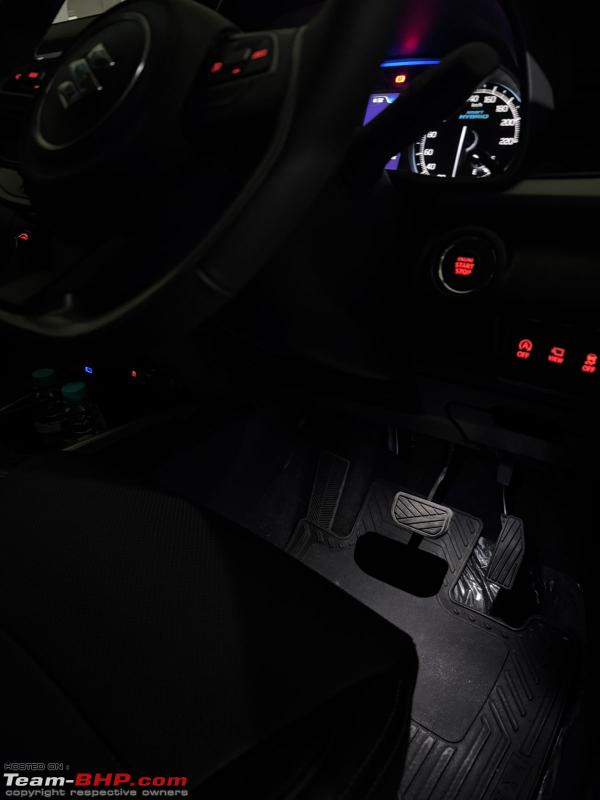

Puddle and Footwell Lights really improve the experience at night

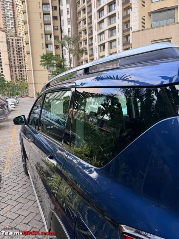

I ended up installing UV-cut glasses on my XL6 too, since they really do help insulate the cabin from heat.
