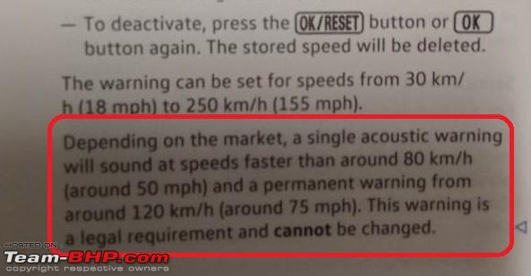

Here's what Volkswagen replied to the email:
According to VW norms, The Multi function display won’t work if any warning message is displayed while the vehicle is in running condition. If the vehicle crosses 80 KMPH, a single acoustic warning will come and if Vehicle crosses 120 KMPH speed a permanent acoustic sound will come.
While the warning message is displayed in the Multi function display, the Driving Data Display won’t work in order to concentrate on driving at higher speeds which was designed for safety measures by VW.
The same was mentioned in the VW manual, images attached for your reference. Please be assured that the performance of your vehicle is meeting all the parameters of Volkswagen and your vehicle is in roadworthy condition.

This is a known issue with the Polo/Vento/ Rapid.
The MID originally had a user configurable speed alarm which can be set anywhere from 30 kmph to 250 kmph. Once the car crosses that set limit, the MID will only show the speed exceeded sign in the MID, just like the video. The other parameters will be locked out.
When the govt rule came into force, the dudes at VW made a shoddy implementation, for which minimum work was required- basically implement a permanent alarm from 80 kmph.
I am not sure if the same occurs in the new Kushaq.
The only solution is to go to a local tuner and remove the speed alarm completely. I believe even VCDS can also be used to remove the speed warning.
