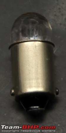

Last night while returning from office I observed that right side tiger lamp is not working. A few minutes back I opened up the casing and it seems that the filament is blown. Now question is should I be going for a regular one or will the LEDs be a direct fit? Also can I presume that LEDs will not cause any nuisance to the electrical and wiring.
Royal Enfield Bullet 500 : "Amun-Ra"-img_8646001_ls.jpg Royal Enfield Bullet 500 : "Amun-Ra"-img_8648001_ls.jpg
Please advise.

LED's that fit the socket are available but many of them, being diodes, are directional.
That is to say, the power supplied to them must be of the correct polarity.
Slightly more expensive are the LED's that are made for use with AC/DC circuits.
They will work regardless of the polarity of the wiring and socket as long as the correct voltage is supplied.
Some of the electrical circuits in the Royal Enfields may be wired such that a normally negative (-) contact is positive (+) and visa versa so it is wise to spend the extra money to buy the AC/DC LED's if you decide to use them instead of a standard incandescent bulb.
