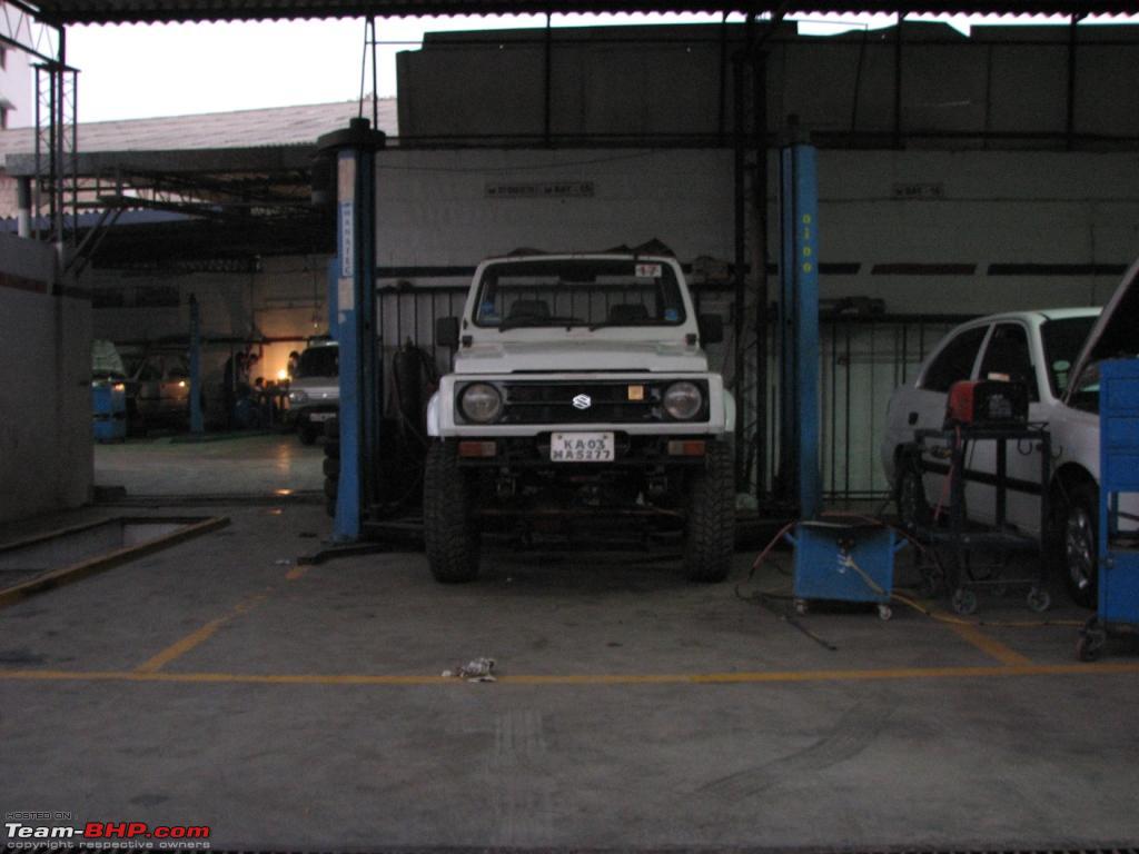

Ok folks, have been getting 'regular' updates over phone from Lokesh@suraksha about the progress so far.
All the structural work is complete and the Gypsy is on it's shoes (tyres) right now and the lift/stance is great. That's what Lokesh has told me so far.
The welding will start now and today late evening I will go and visit the garage to see the Gypsy for myself.

Ok, here is a picture of work done so far and how the Gypsy looks right now.
Gypsy on Steroids -- The SPoA Project.  EDIT: Stage-2 Started now..-img_1235.jpg

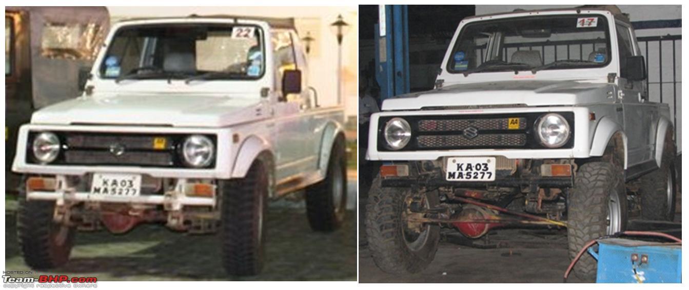

Here is a difference between the gypsy with SPUA & SPOA.
Gypsy on Steroids -- The SPoA Project.  EDIT: Stage-2 Started now..-comparision.jpg
Lots of small small but very very important work still left.
Needless to say, am very very happy with the work so far and how the Gypsy is shaping up.
