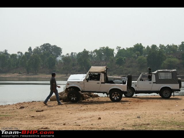

Here is a picture of the Gypsy after SPoA.
Gypsy on Steroids -- The SPoA Project.  EDIT: Stage-2 Started now..-dsc00166.jpg
Gypsy on Steroids -- The SPoA Project.  EDIT: Stage-2 Started now..-dsc00274.jpg

SPoA - Tested OK
Here is the another pic of JEEPsy. Testing the articulation and the travel of the axle.
Gypsy on Steroids -- The SPoA Project.  EDIT: Stage-2 Started now..-dsc01606.jpg

Well, It can climb this
Gypsy on Steroids -- The SPoA Project.  EDIT: Stage-2 Started now..-dsc00051.jpg
and this
Gypsy on Steroids -- The SPoA Project.  EDIT: Stage-2 Started now..-dsc00085.jpg
and this
Gypsy on Steroids -- The SPoA Project.  EDIT: Stage-2 Started now..-dsc00088.jpg
and this
Gypsy on Steroids -- The SPoA Project.  EDIT: Stage-2 Started now..-dsc00093.jpg
But still can't do this
Gypsy on Steroids -- The SPoA Project.  EDIT: Stage-2 Started now..-dsc00135.jpg
On a serious note, the SPoA job is just tooo good and opens up lots of possibilities and doors for more serious off-roading. Better articulation, better GC, better control over rocks..
The Gypsy rocks now man. The Lockers + t-case + short rear & the SPoA are now working in complete harmony and complimenting each other.
