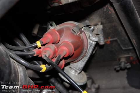

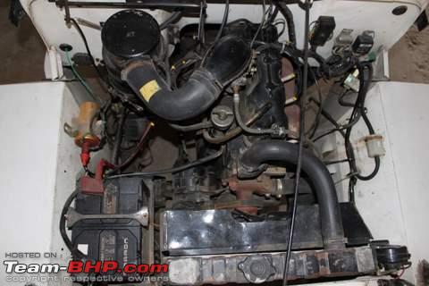

engine pictures
uploading some pictures
1. the engine bay
2. the mechanical fuel pump
3. the oil pump which is supposedly of some rare type as described in the previous post
4. the distributor, which matches to my oil pump
docfreak is offline

Isn't that the oil filter assembly? and the distributor seems to be the lucas ones?

you are spot on , its lucas , but has a small difference which i have outlined in the previous post , which i am not sure is actually true?
