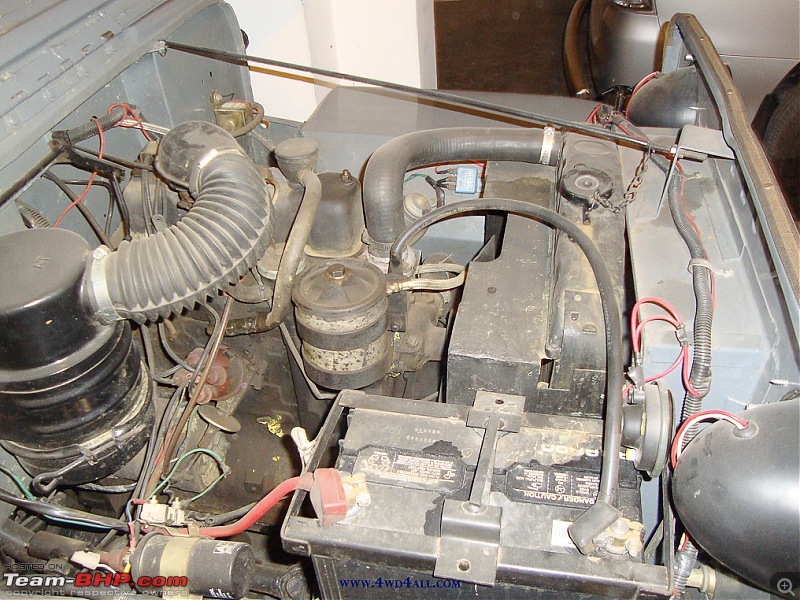

Regarding Oil Bath Air Filter
Needed input on 2 things
1> On opening the oil bath air filter of the CJ, the mech suddenly said it was missing the metal 'kanthi' element. On decoding it meant that he was expecting some steel wool type packing in there and not expecting it to be empty. Do CJ air filters have such a thing? If so where can i find it.
2> What oil should I put in the air filter. It is bone dry right now
Third bonus question:
In an oil bath filter, what prevents from getting the oil getting sucked into the air supply in case of a heavy landing causing a huge splash/severe tilting/toppling of vehicle?
Attaching a much older picture of the engine bay for reference

Posts: 20,383
Thanked: 17,296 Times
Re: All questions for CJ 3B
I dont remember seeing the mesh in my 3B also. I use engine oil in the filter plate. Yes splash or oil feeding the crab is a possibility in certain scenario, iirc have seen it happen in a diesel engine.
Now question from my side, if we are to upgrade to paper filter system. Which one is ideal, bolero unit?
Hi Soumya,
1) IIRC The Steel Wool is filled in the Air-Filter Body. That cannot be replaced. The bottom of the barrel has perforated Steel Element which reduces/prevent such splashes.
http://www.film.queensu.ca/cj3b/Phot...erParts300.JPG
2) Engine Oil
3) Bonus Answer.
We recently faced this dilemma in the Aavalakonda OTR, the Toppled MM540 refused to start, could barely take a crank.
We checked the following
1) Battery and Connections
2) Starter Motor
3) Finally we realized the Oil from the Air-Filter had entered the cylinder head and caused a lock. So we removed the Heater/Glow Plug and cranked the Engine, there was Engine Oil in No2 Cylinder. The vehicle started and smoked for a few seconds before getting back to normal.
So in a Petrol Engine remove the Spark Plugs, after numbering the cables and crank to remove non combustible foreign matter .
Arka
PS - You can change to the MDI3200TC Plastic Drum Type Air-Filter.
