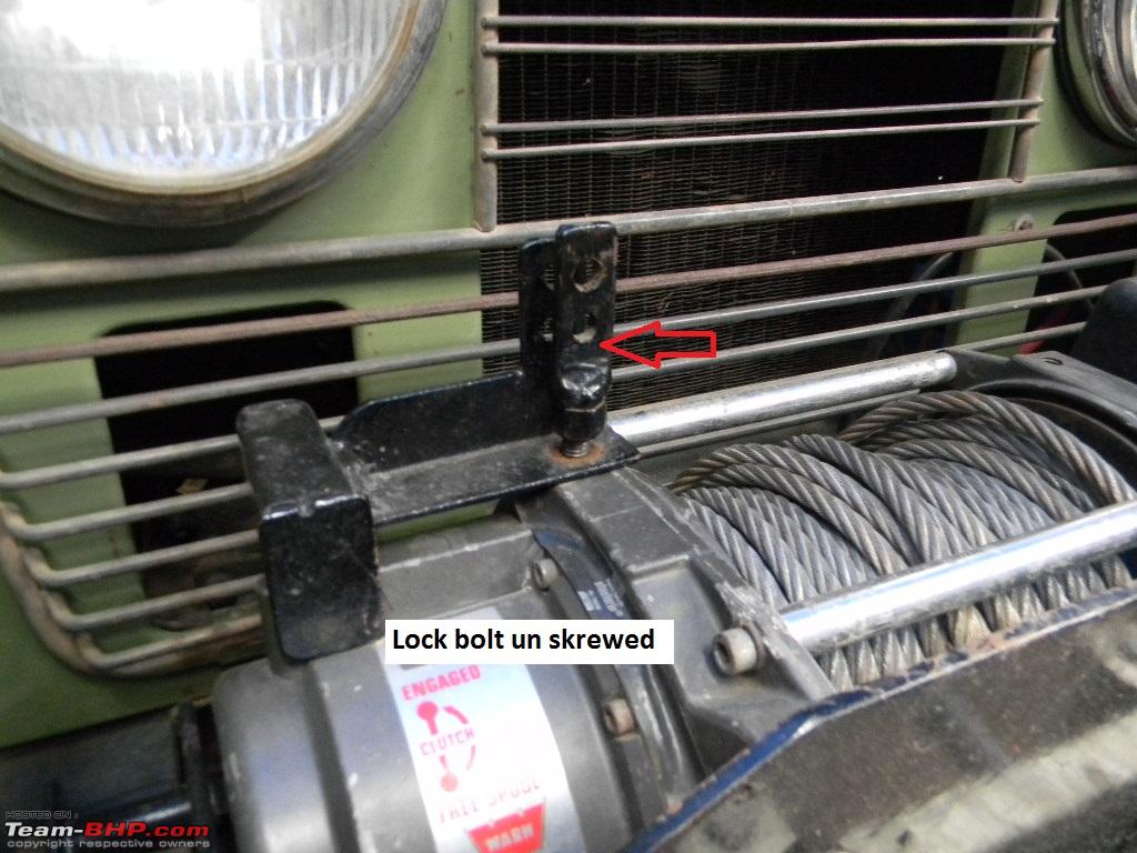

A winch lock
Hello I want to share few pics of a Vandal proof winch lock .
This lock gives protection to the clutch - free/engage lever ( which is otherwise exposed for anyone ) . as well as to the free end of the rope .
a simple padlock of your choice can be used
Sudarshan, it is not entirely clear. Can you show how it looks when disengaged? A video of the locking operation would be great.
Well I try my bit to explain by pics .Please bear with me ,as I have no video facility with me .
Hope it will serve the purpose .

^^ One word
NEAT
Superb innovation, I am sure necessity was the mother of all inventions?
