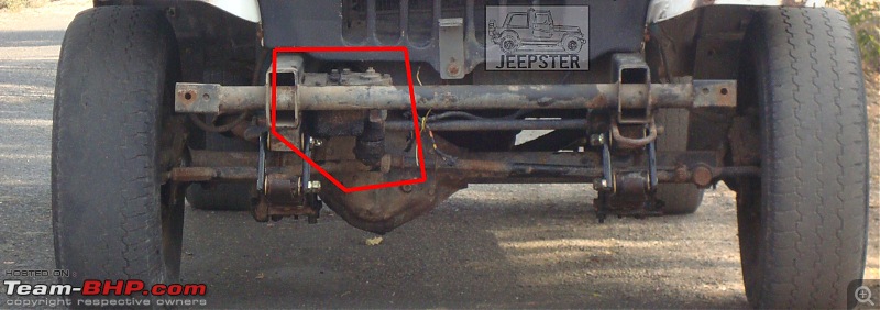

Is this the Rane type steering box meant for Armada?
this is the rane (OE) RCBT steering box.

Samu -- are you looking for the OE (Position) replacement one? Or the 'chassis cut and weld' one? Looks like we need a new thread for jeep steering options and correct technical names. Too low a clarity here.

I am thoroughly confused now.
Ok, at the JT anniversary event in Chennai this year, I was shown 3-4 different types of steering systems.
1) Stock steering system with no Universal Joint.
2) Steering system with Universal Joint.
Then things got muddled. There is the Rane type that came with Major and then with Armada. Both have universal joint. But only one of them is bolt-on on my Jeep.

I just fitted the bolt-on universal joint type steering g/b and assembly. Pics on my thread. It works very well with even 31" tyres so it seems like the most practical option to go for.
