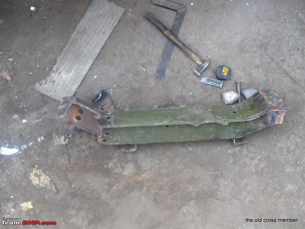

  • The denting work has been completed
  • The front cross member which was cut by the old workshop for reasons unable to be understood by me has been replaced after sourcing a another one from another chassis in Mayapuri.

Sometimes the cross member is cut to install the PS box (the rear of the PS box can be recessed slightly into the area of the cross member). If this is done then it should be kept to a minimum and stiffening plates added to keep its strength.

This I know that he cut the cross member to fit the power steering. But just tryinng to understand the reasoning behind it. I had specifically mentioned that the vehicle will be used for OTR's and with this level of cutting the cross member, the complete reliability of the vehicles is at question.
Isnt It??
But anyways, I am going to keep this 4x4 for a long time now, and whatever fault, issue comes up I will be replacing it with genuine parts, wherever and whenever required!!!

Yes he has cut too much and without adding stiffening plates. Maybe he found it easier to cut a big chunk out rather than making a measured recess cut in the cross member.

This guy completely removed the cross member and later welded in a custom fabricated one (looks like a scafold pole to me).
Saginaw Steering Conversion on The Jeep CJ3B Page
Another way to retain the original cross member and retain its integrity :
FJ40
