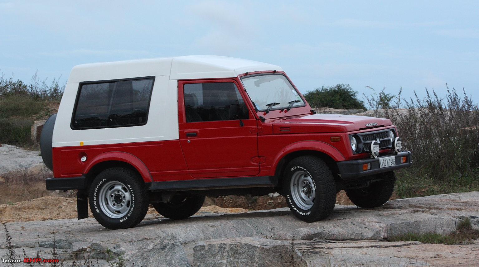

Spent some time today with this one. Didn't drive it though. Red white combination looks really nice. It was pretty late to do proper justice as a shot. But there's always next time.
Actually this is one test shot for me. 2X extender with 70-200. This is at 400mm.
Dear Rudra Sir,
Thank you so much for taking time off and gifting me such a wonderful picture of my Gypsy. It was really nice to meet you and Jaggu today. I was also very happy to see your Ambi in real. It not just looks great, but sounds great and is super quick. Am in love with it Thanks once again Rudra Sir.
