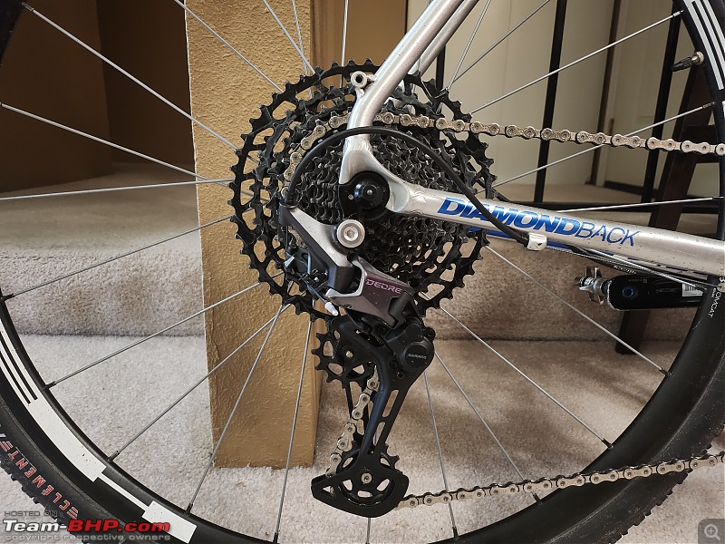

Fixed some things after two rides on the bike. That stem was first to go. Installed the OG Diamondback 7 degree stem in + configuration.
Next and some what unexpected change warranted by real life conditions was the brake levers with more clearance for fingers. Since it’s quite cold here I am riding with thick gloves and earlier Tektro ones left almost no space between lever and handlebar. Shifting was especially difficult too - so they got the boot and Chinese levers were put into duty which have quite the clearance for large hands and thick fingers of mine. Cheap but have nice clicky feel.
Next up were pedals. Once you are used to clipless the advantages are hard to ignore. So out with flat pedals, in with Crankbrothers eggbeaters.
And finally the cassette. Found an even larger SRAM variant (11-50) on Craigslist that is compatible with Shimano HG hubs. It’s definitely an upgrade over previous Chinese make cassette with 46 teeth as far as shifting performance goes. Shifting is now even smoother. Have kept the previous hub as a spare. Did not increase the chain length from prior setup. There is slightly more tension than before but manageable. Forgot to weigh it but I am guessing it’s close to 600 grams.
Also meddled with grips made for flatbars but went back to thick roadbike bartape from Fizik. At 2.7mm thickness it provides enough cushion.
