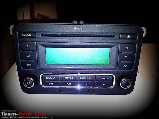

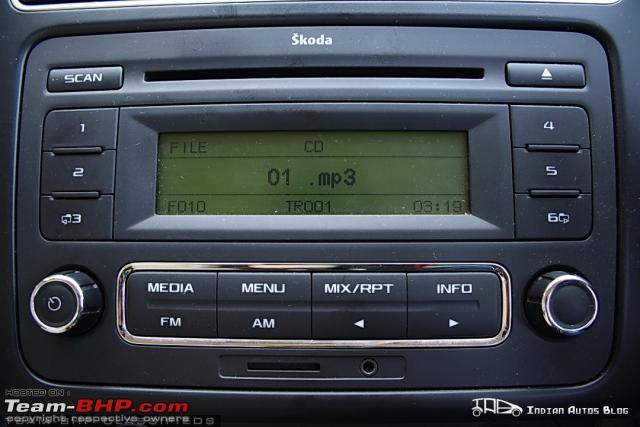

Would it be possible for you to get some pics of the existing OE HU in the Rapid (installed in the dash or outside), and the Fabia dash without HU?
DerAlte is offline
The following are of the Head-unit. I picked them up from our classified section as the HU being offered is the same .
My relative bbm'ed me the pic, however the car was parked in the basement and hence the pic is a bit dark :-

Would have been nice to look at the dash pic of Rapid too.
To me it looks like it is a drop in replacement in the Fabia dash. A.S.S. mechanics should be able to figure that out. Best is, he should get an ICE installer and a Skoda mechanic to work together. The mechanic would be able to figure out how to mount the OE unit. The ICE guy will be able to figure where the harness is terminated, and get the appropriate connector adapter for that. If the A.S.S. doesn't want to take it up, one can get the mechanic to do a quick outside job on an off-day.
