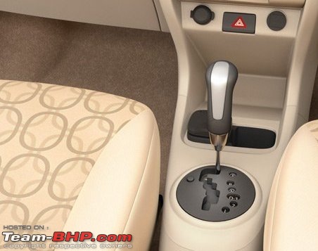

Hey Gurus...
I got an Astar A/T for a test drive which had a USB port in it right next to the Hazard indicator switch.. it was a November manufactured car. Later on when i got my car the there was no port but the space for the port is simply covered with a cap. My car is October manufactured.. And the amazing thing is that NoNE of the guys in the showroom or Service area know about this.. Its almost as if it appeared there by MAGIC..
Is there an aftermarket cable which can be fixed to the back of the Inbuilt stereo system to connect a USB??
Whom can i contact in MSIL to get detains about this?
Also is it possible to have a double din HU fitted in ASTAR?
Ive also attached a pic which was taken from a site... Couldnt take the interior photo of the car they bought for testdrive but it looks exactly the same

Originally Posted by living_fossil View Post
... Is there an aftermarket cable which can be fixed to the back of the Inbuilt stereo system to connect a USB?? ...
Depends on whether the OE HU has a port that can be extended to the dash location. To know whether there is, or not, you need to take out the HU and read the sticker on top of the HU.
Doesn't matter if the showroom guys didn't know, just ask them to take the HU out (a simple task) so that you can read the sticker. If there is a provision in the HU, you would need an extender cable (plug on one side, socket on the other) that you can use to connect it to the dash location.
If the car came with the HU manual, you *just might* find details in that. Of course, the snafu is that the manual may be common for a group of HUs. To be sure, you have to check the HU model number anyhow by taking out the HU and reading the sticker.
No idea whether a 2DIN HU can be mounted in the place of the OE HU, unless you post a pic of the dash of *your* car.

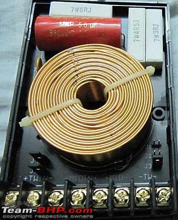

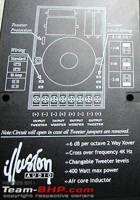

Can anybody guide me to set up the xover for illusion carbon nd6.1. The xovers have two sets of jumpers. one for the tweeter level control, and other for use of xover with standard/bi-amp option.
I have both the jumpers for wiring in the open position. The jumper for tweeters is in the 0dB position.
I am using a two channel amplifier for powering the speakers.

for 0db J1 and J3 need to be closed but in your picture I see only J1 closed.
For biamp both jumperns on the left need to be open. But then you need a 4 channel amp to drive the speakers. If you are using a 2 channel amp then leave the jumpers where they are.
BTW I would try -2db position for the tweeters (closing J1 and J2).

Navin, the xovers are presently jumped at 0dB, i.e. the middle, or J2 jumper is connected.
But for the wiring, both connections are open. No jumper is there. The pics are slightly misleading to that end.

I believe (from memory alone) that both jumpers open are used when biamping and both are closed when using a single 2 channel amplifier.
I would PM Bass and Trouble (Ajay kamath) as he has some knowledge here.
