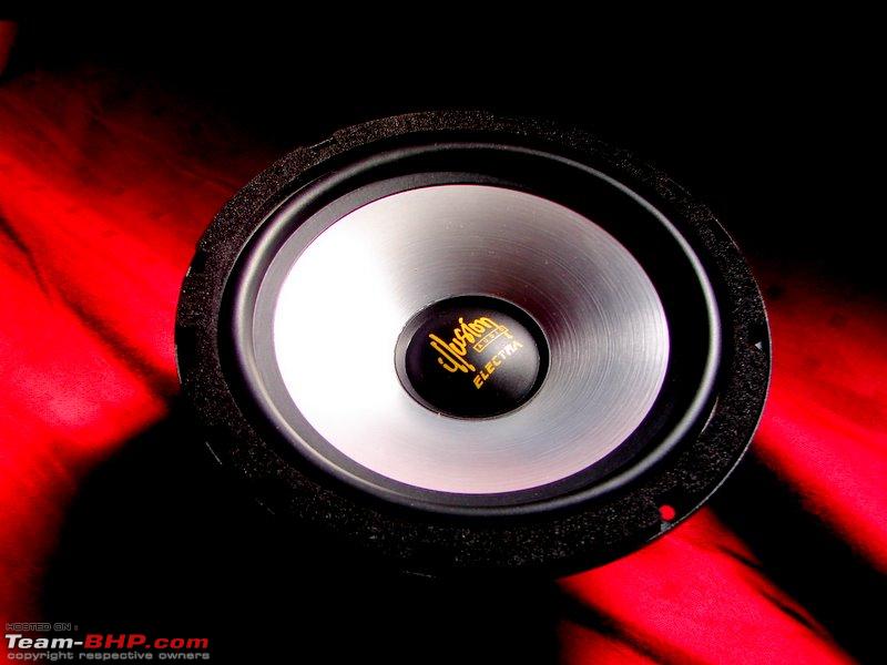

It's just an illusion EL6.1 component and EL52 coaxials
Today is a happy day.Finally received the speakers. Thanks Ajay was wonderful dealing with you.
The first bit of my ICE set up is here.Just can't wait to have everything in place and get them installed soon.
These are supposedly the new 6.1 components. The plan as of now is to power the 4 speakers with an amp, and maybe after a few months of saving up get a 2 channel amp and a sub.
Cheers.
