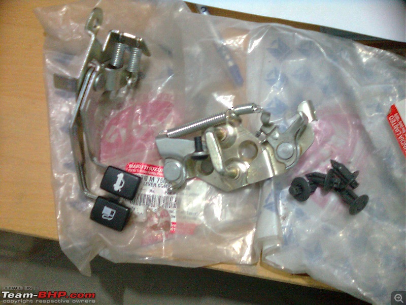

Old 24th February 2018, 21:18   #216
numerouno.no1's Avatar
Join Date: May 2015
Location: new delhi
Posts: 149
Thanked: 302 Times
Re: Mission accomplished!!!
Originally Posted by sabret00the View Post
Took my car for servicing to MASS this morning. I had earlier spoken the Service Engineer who takes care of my car. He was a little hesitant but when I explained it to him that he doesnt need to modify anything since it's a direct fit from the ALTO VX. So he got hold of an enterprising mechanic who was more enthusiastic than me to get the Boot Release thing done. There are basically 3 things required. The new switch with 2 levers which replaces the existing one with 1 lever. The cable which connects the lock with the switch. And a new lock which has a hinge on it to hold the cable onto it. Took the mechanic barely 15-20 minutes to do the entire fitting. IMHO one doesnt even need to go to a mechanic or to MASS. Dedicate a Sunday morning to it and post a new DIY thread .
I'm posting poor quality cellphone pics for the time being. I'll post high resolution day time pics and the part number of the spares required for the entire job.
NOTE: No modifications were required. The 3 parts from the ALTO VX I mentioned above are direct fit onto the new ALTO Lxi.
Can you give me the part number because I purchased 76520-76G10 and its the regular one not the one you mentioned. The part no. is same as lxi.
Please provide the part number of the extra attachment that goes on with the striker assembly(in green ✓).

Old 15th March 2018, 19:28   #217
Posts: 107
Thanked: 132 Times
Below are the listed part numbers required for conversion:
Sl.# ---Part # -----------Description-----------Qty----Price
1. ____ 82650 M79 G00___Striker, Back door Latch_1 No._ 34.95
2. ____ 83310 M76 G50___ Lever, Fuel Lid Opener __1 No._47.20
3. ____ 83350 M79 G20___Cable, Back door opener__1 No._98.92
