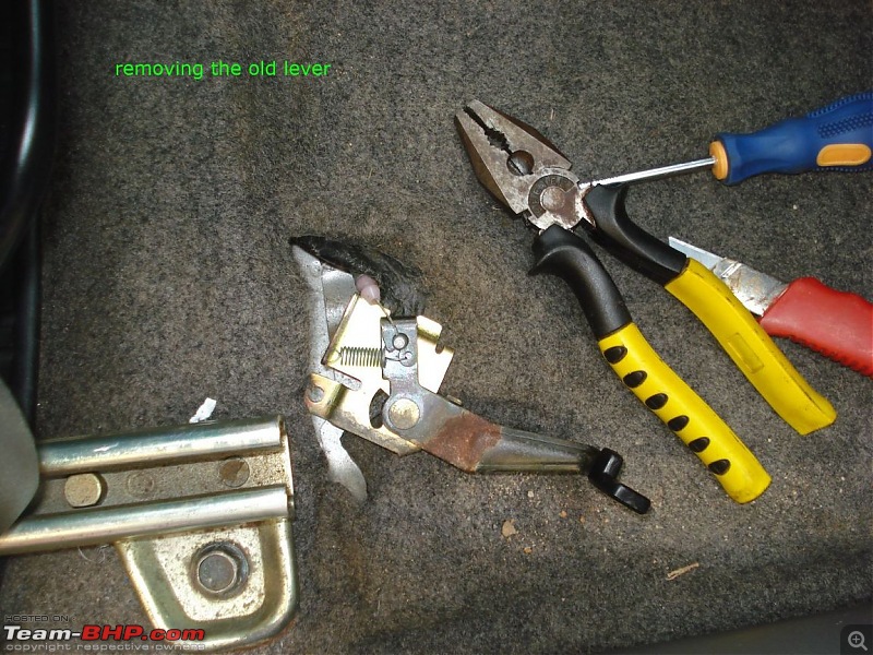

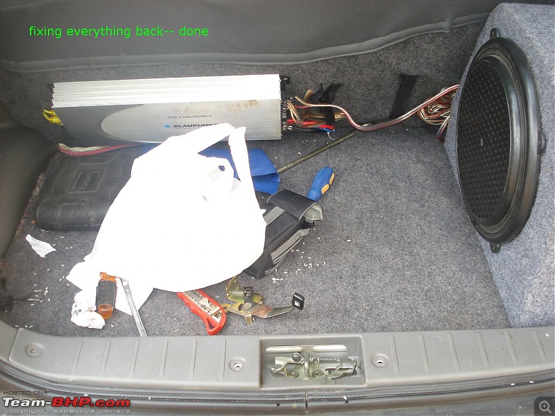

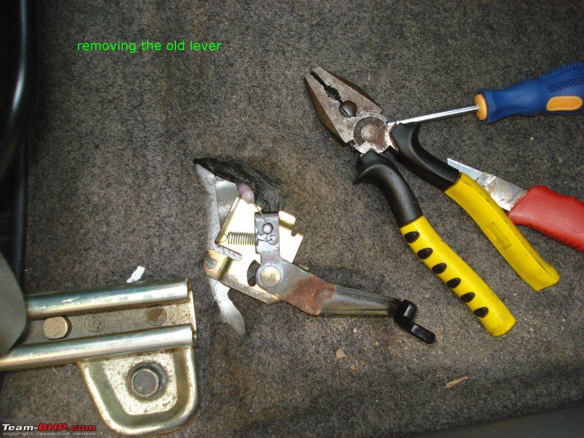

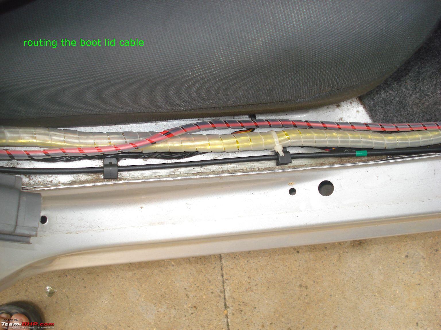

After reading this thread could not sleep on Monday and Tuesday. Took 2 hrs off from office and went to Essar automobile to find the spares are out of stock. Searched in J.C road could find only cable in CAR Automobiles and paid 170rs and brought it. Went back to ESSAR ordered all spares. Their executive Shankar helped me to get the spares. He called me three time to update the status and on Saturday and confirmed the spares availability. Got the spares and finished the job in 15Min on Sunday morning before the breakfast
Remote Boot Opener in ALTO LXi - Edit: Info on Pg 3 & 8 and a Detailed DIY on pg 13-old-striker.jpg
Remote Boot Opener in ALTO LXi - Edit: Info on Pg 3 & 8 and a Detailed DIY on pg 13-new-striker.jpg
Remote Boot Opener in ALTO LXi - Edit: Info on Pg 3 & 8 and a Detailed DIY on pg 13-old-lever.jpg
Remote Boot Opener in ALTO LXi - Edit: Info on Pg 3 & 8 and a Detailed DIY on pg 13-new-lever.jpg
Remote Boot Opener in ALTO LXi - Edit: Info on Pg 3 & 8 and a Detailed DIY on pg 13-routing.jpg
Remote Boot Opener in ALTO LXi - Edit: Info on Pg 3 & 8 and a Detailed DIY on pg 13-fixing-bk.jpg
Remote Boot Opener in ALTO LXi - Edit: Info on Pg 3 & 8 and a Detailed DIY on pg 13-done.jpg

exactly what i needed. 1 question. Why would you have to change the fuel lid cable? can't the existing cable work?

You can use the cable but needs to route properly, otherwise boot lid will not lock. But it is manageable just role the cable and don't tie near right corner of the wheel well
