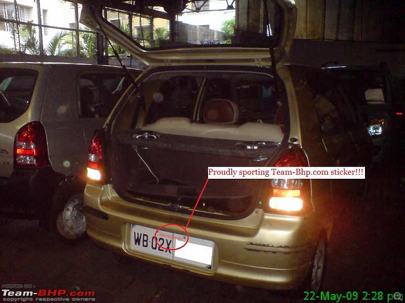

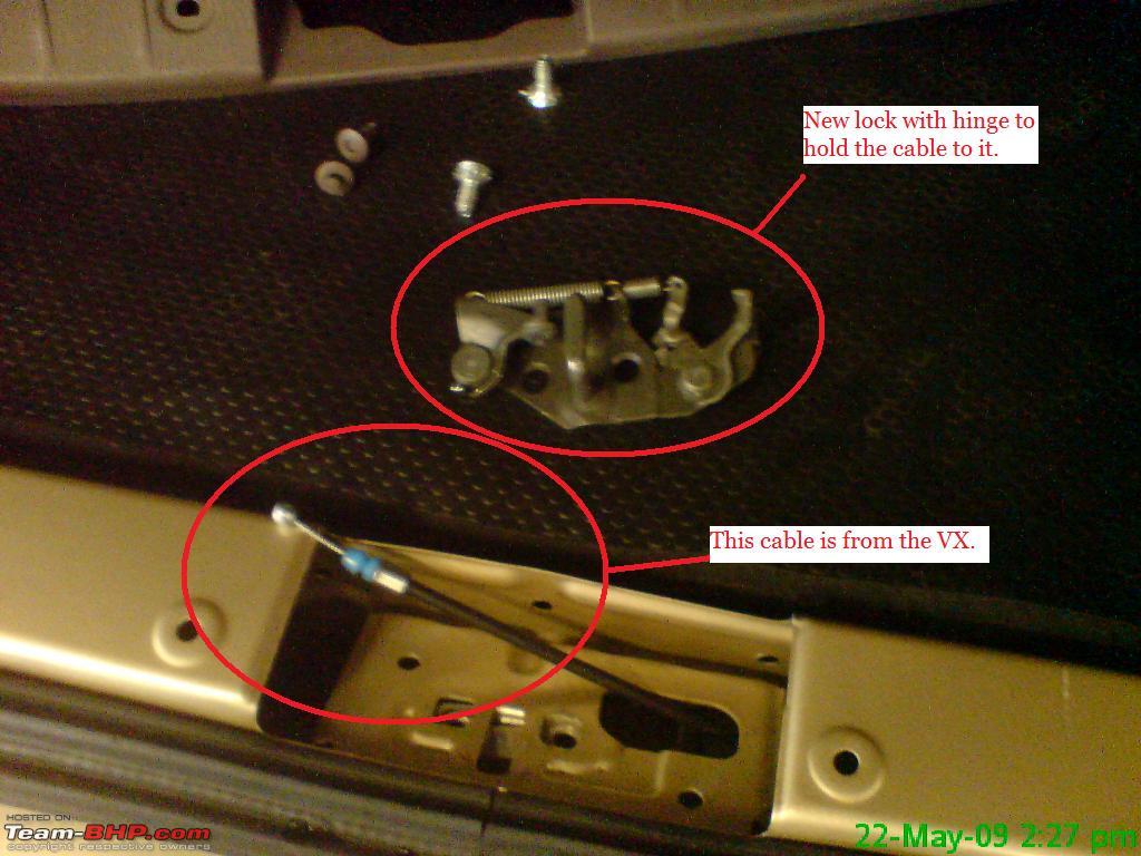

Took my car for servicing to MASS this morning. I had earlier spoken the Service Engineer who takes care of my car. He was a little hesitant but when I explained it to him that he doesnt need to modify anything since it's a direct fit from the ALTO VX. So he got hold of an enterprising mechanic who was more enthusiastic than me to get the Boot Release thing done. There are basically 3 things required. The new switch with 2 levers which replaces the existing one with 1 lever. The cable which connects the lock with the switch. And a new lock which has a hinge on it to hold the cable onto it. Took the mechanic barely 15-20 minutes to do the entire fitting. IMHO one doesnt even need to go to a mechanic or to MASS. Dedicate a Sunday morning to it and post a new DIY thread .
I'm posting poor quality cellphone pics for the time being. I'll post high resolution day time pics and the part number of the spares required for the entire job.
NOTE: No modifications were required. The 3 parts from the ALTO VX I mentioned above are direct fit onto the new ALTO Lxi.
