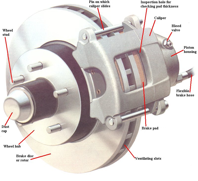

Yes, the right side nut is the grease nut which is used for releasing the air bubbles from the cylinder and the left bolt is the brake fluid line connector bolt. I had the same experience some time back when I was about to fix the “ABS” from KRP. Being a hard core DIY fan, I fixed it myself and tried unscrew the grease nut to release the air bubbles but that ended up in a bad shape and took help from a tool work shop guy. He welded a small piece of iron rod onto the bolt in T shape and then applied with a locking plier, phew.. it came out well. I think the thread was usual ACW to unscrew. The only hard part was to find a substitute for the grease nut. I think this tip will work to pull out the fluid line bolt too, but may be at the cost of the fluid hose while welding on the bolt. I would suggest you to get help from a workshop who has the knack of doing it better than us. You will get the fluid line connector bolts from auto spare shops only thing is to make sure the thread pattern.
That's a fantastic idea, really a GREAT tip
What I'll do is, probably use a little larger dia T shape tube & get it welded outside the first bolt (grease nut?), remove the nut & then let it remain there for removing next time. I'll remove the calipers or the entire assembly into pieces & take only the calipers to avoid damage on the hose.
I guess its called bleed valve, I could be wrong though.
Source - http://www.motorera.com/dictionary/p...disc_brake.jpg
