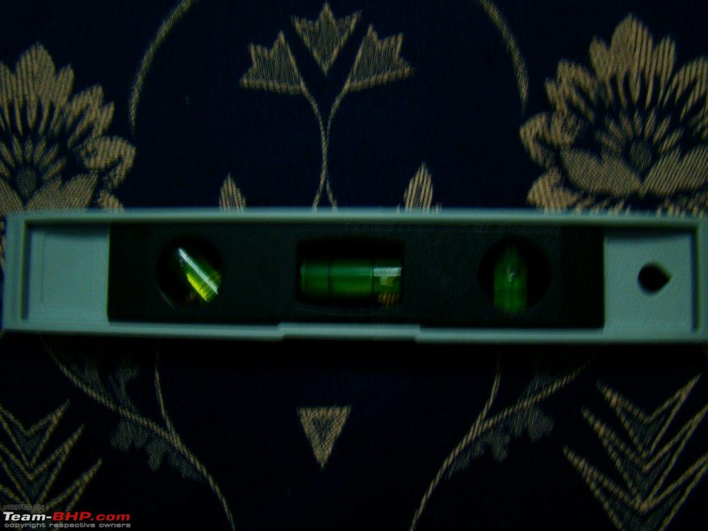

Originally Posted by DerAlte View Post
Depending on whether the drill is vertical or horizontal while drilling, and assuming the surface where the hole is to be made is horizontal or vertical correspondingly, and you have punched a starter hole ...
Position the bit tip in the starter hole. Before you switch the drill on, you will need to check the spirit-levels simultaneously to see if the bubbles are in the center. While drilling, check a few times whether the bubbles are still in the center. If not, slowly move the drill appropriately to get them back in center.
Ohho! That's the reading part, I know how to read a spirit level but I don't know where does it fix on my BOSCH GSB 13RE Drill machine! That's the confusion. Thanks a lot anyways.

Originally Posted by abhipuru16 View Post
... help me identify the types of drill bits ...
... I don't know where does it fix on my BOSCH GSB 13RE Drill ...
@abhipuru, difficult to visualize without seeing it. Could you please post pictures of the drill bits, the spirit level and the drill?

[4.] Spirit level vials-Tools for a DIYer-dsc01486.jpgTools for a DIYer-dsc01487.jpgTools for a DIYer-dsc01488.jpg

1. That spirit level is not meant to be attached to the drill gun - it can only be used to align surfaces. You could perhaps tie it with rubber bands to the side of the drill (lengthwise) and try, though I am not sure of the effectiveness
