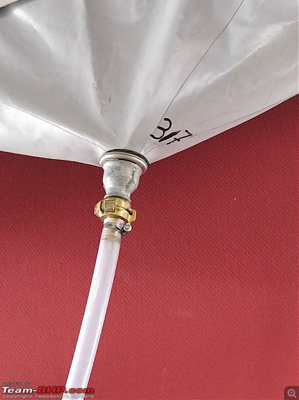

Am looking for a rain water diverter like this. Saw this in Frankfurt Airport. I have a leaking roof where rain water drips in and messes the washing machine placed below. The roof has a sliding door to get to the terrace in our service area.
I tried aliexpress but couldnt find it there. Planning a DIY with simple tarpaulin sheet and a garden hose adapter if finding one at a reasonable price becomes difficult.
