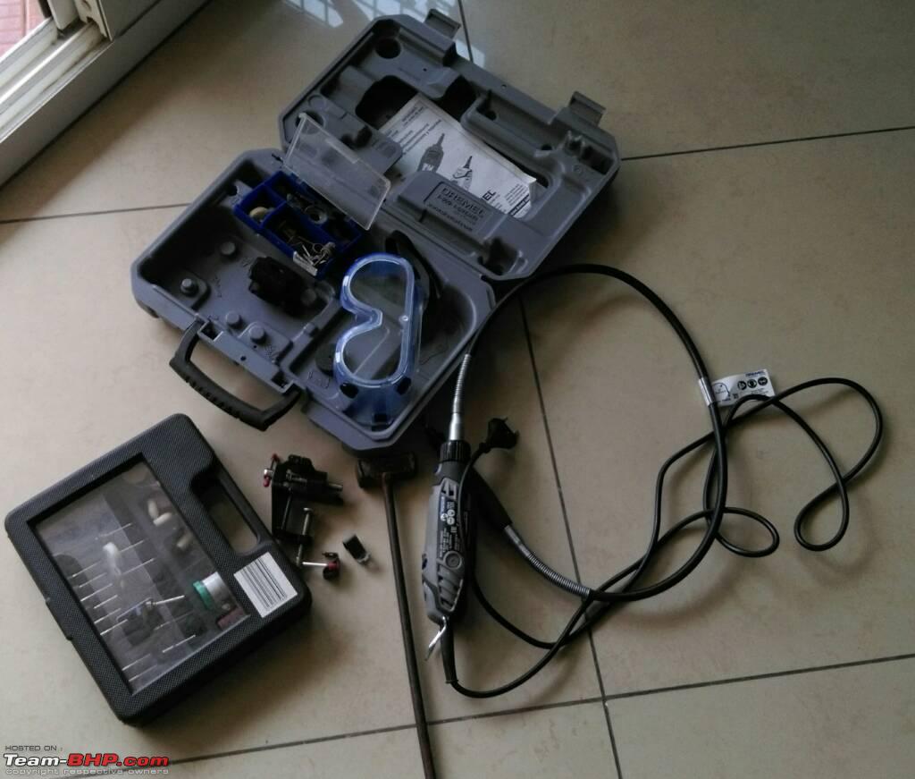

I have this dremel tool and a hobby vice, both doing good duty to my regular work. The black box is extra set of bits from UK.
