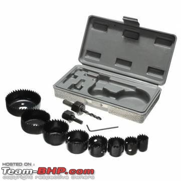

What you can do is the following
. Find a workshop that has a wood working lathe
. Get hold of a piece of wood block (same thickness as your door), and get it rounded in the lathe to a size marginally bigger than the existing hole
. Get the lathe operator to drill a pilot hole (say 5-6mm) in the centre. That way you get the true centre.
. Check the fit and if it is too tight sand it a bit. The piece should be tight enough to need a bit of hammering. Use wood glue on both the surfaces and hammer the piece into existing hole, so that it is a tight fit.
. Use a hole saw to drill a hole of the diameter of new lock
http://www.amazon.in/19-64mm-Metal-A...s=hole+saw+set
http://www.amazon.in/Bosch-11-Piece-...s=hole+saw+set
. Once you have the hole, next use headless nails to secure the collar to the door, that is drive the nail from inside the hole towards the door, radially. Two nails at opposite end would do.
A hole saw is an excellent addition to tool set. Even if you use it once, it pays for itself. I bought one ten years ago and have made a few holes in plywood.
