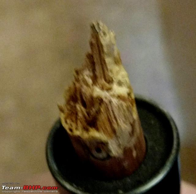

Forgive the blur, but you can get the idea that it is a typical broken-stick kind of injury. The sort that should, more or less, push back together in a decent fit. It seems maybe it broke in the same place as before. Perhaps the glue wasn't as good as I thought. Maybe I will just JB-Weld it. It will be tough. though, to get it to run into all the crannies. And tough to clean up.
Hmmm... Have a large bottle of Fevicol handy.
Epoxy glue seems to be the only solution for this kinda injury. We used to fix broken table tennis bat handles with Araldite and this is a similar case.
A quick-set Epoxy glue is what you need otherwise the handle might move before the glue dries up and sets.
You can later try and procure a clear Epoxy wood finish and coat the whole handle in a thick coat so that the repair doesn't look ugly.
P.S. - Fevicol or normal wood glue won't work because you won't be able to clamp and apply pressure for the glue to set without breaking the handle again. Those glues are used when two pieces of wood can be joined while applying pressure, which is not the case here.

Yes, you are right on both those counts.
I was just thinking about something I only heard of yesterday: superglue and sodium bicarbonate. But it seems that it sets very, very fast and that might not give me time to manipulate the wood into position.

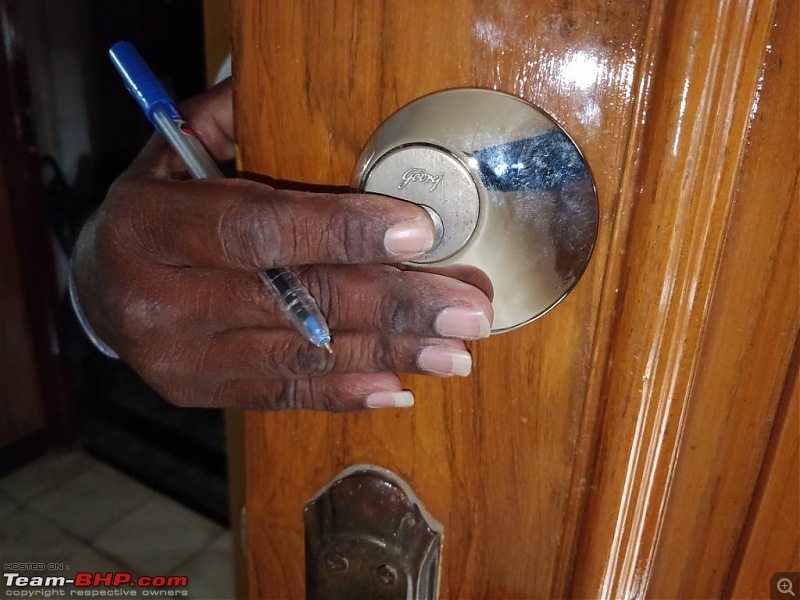

As an update to my saga of switching out an older godrej night latch with a newer smaller one, I called godrej support and they sent me a technician to do this. He had the adapter and tried the swap. We realized that the lever that helps turn the locking mechanism when the key is rotated was shorter as the door in which I was planning to install it was thicker than the door where it was earlier installed. So dropped the plan to swap and will purchase a new one along with an adapter. The adapter costs 350rs. The adapter feels very solid and is a good solution to fitting a smaller lock in a larger door hole with minimal fuss and woodwork. However there could be other complications like thickness of door and position of screws etc which will impact your lock decision.
