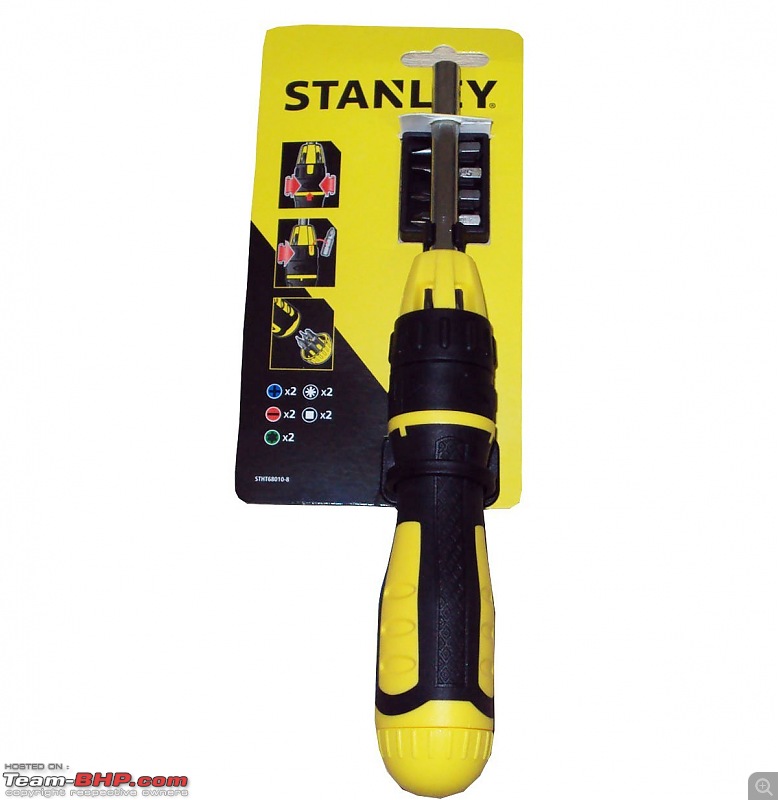

I also got myself one Stanley ratcheting screwdriver. And I already put it to some use. It did help in fastening/ unfastening quickly while servicing my washing machine. This one: (pic taken from amazon)

I have that screwdriver too. The double-speed thing is actually useful for doing stuff like taking those far-too-long screws that hold electrical switches/sockets to their wall boxes. Except that now I have a cheapo battery driver for that kind of job.

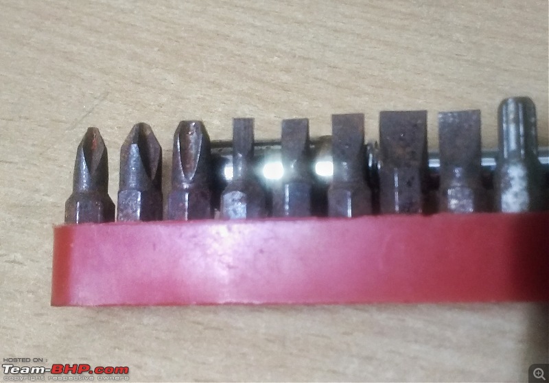

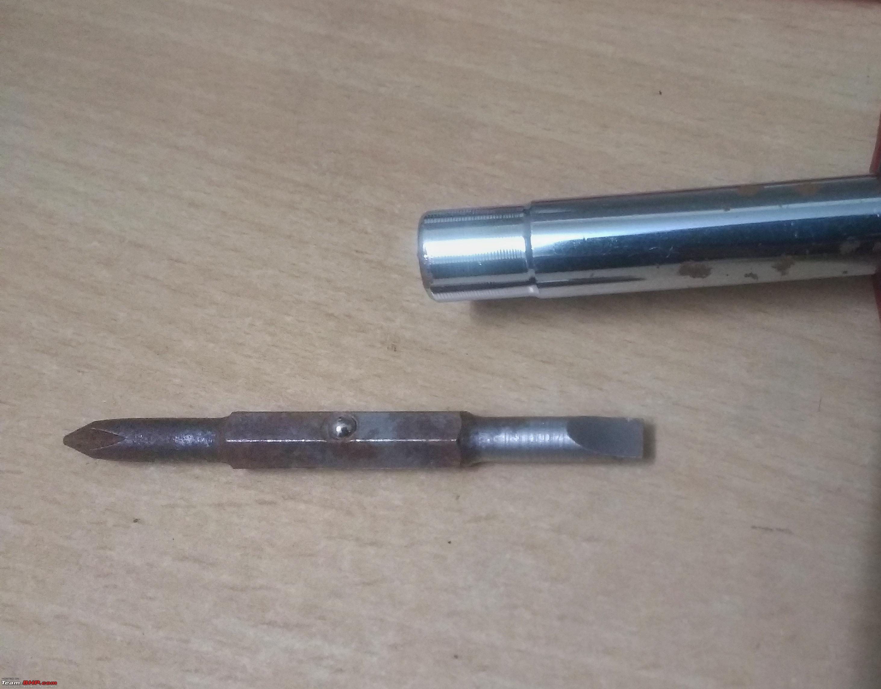

How to prevent rust on screwdriver bits? I have tried using sandpaper & applying little oil but rust reappears after few months. Section of bit not exposed to air doesn't rust though, check flat bit of 2nd image.

I'm afraid that the only answer, probably, is to buy bits that don't rust.
Otherwise... Keep the oxygen away from the iron: lightly oil them.

Rust is primarily caused by humidity. Use a rust remover to get rid of the rust.
Thereafter, keep all tools away from damp places and coat them with WD-40 or a light oil for e.g. sewing machine oil. You can also apply a very thin coat of vaseline (preferred over grease) as with car battery clamps and terminals.

Store in Tupperware or similar.
And buy better quality bits!

A lot of the bits that come in sets rust. We need some miracle substance the covers without leaving stickiness.
How would a slight smearing of silicon grease work, I wonder?
OK, I just wire-brushed and silicon-grease smeared the bits with my favourite Skill ratchet screwdriver, which had got some rust. Ask me in a couple of years!
