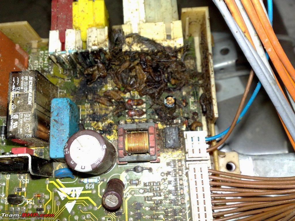

How best to get service for my European Bosch washing machine? ...
Originally Posted by filcord View Post
Try and see if there's an authorised Bosch service point in your city. ...
Have realised that Bosch and Siemens are sister companies with respect to domestic appliances, so Siemens is more likely to be able to help me than the tools division of Bosch.

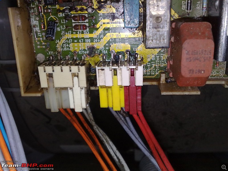

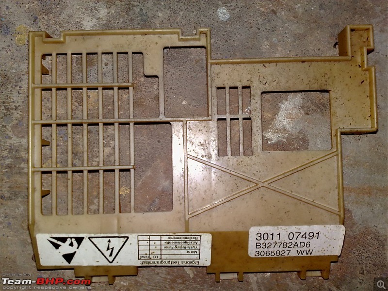

I've made further investigations and found the cause of the problem... a dead rat in main controller. A rotted dead rat. Although the machine is in an open-air passage way, I cannot understand why we never smelt anything.
You can see the progress. I didn't photograph the rat in place, as I didn't know what it was before removal.
The close up was my way of noting the connector positions for replacement after cleaning, but it can be seen that there is some damage to the board near the two connector blocks. I cleaned and dried the board, and reassembled --- but no result. It still has some functions working, but will not wash. something must have shorted.

I know this is off topic and completely useless but I just can't resist asking...........how the hell did the rat die? Did it get electrocuted, crushed, ground or a combination of the above?
The only way one tell it's a rat is by it's teeth.......and are those maggots on the circuit board?
Wolfheart is offline
Old 14th September 2009, 15:03   #475
Thad E Ginathom's Avatar
Posts: 11,458
Thanked: 30,107 Times
There was a cover over that board, and yes those are maggots.
By the size of the contacts, and (I guess, I really know nothing about electronics) by the size of the traces on the board in that area, I would think high voltages would be there. I guess the rat was just in the wrong place at the wrong time. Finding dead maggots is quite unusual; I guess they must have been electrocuted too --- and the whole nasty mess was probably cooked after that
Wow! The rat's head (or whatever's left of it) is contorted in a pretty gruesome way!
Anyway, in all likelihood you have probably done this alredy but make sure that you have disinfected the machine and the space that the machine occupies. Would'nt hurt if you could also sterilise the clothes that you may have washed just before the grisly discovery. Apart from a host of other diseases, rats in India sometimes carry leptospirosis which can be fatal.
