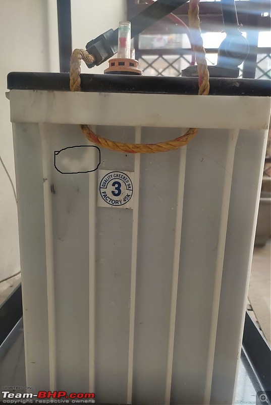

Hello everyone, so after going through lots of pages on this thread i went ahead and purchased an Exide battery but what has started is an unfortunate chain of events.
In March i had purchased the EL150 battery and it was delivered to me by the dealer and later on fitted by an electrician, the place where i live sees a power cut off around 1 to 2 hours daily but now it has reduced. So after 3 months i noticed that only one of the cells has dropped to 3/4 th mark so instinctively i lifted the battery and checked for any cracks/damages which there weren't any and neither the battery was wet so i assumed it was normal due to regular usage now around October i noticed it has seeped down to 1/4th level so i filled it and since then cell started to leak rapidly and getting empty in 1 month so i called the customer care, the guy arrived and upon first inspection checked the battery and wanted to take it to service centre but upon further inspection a crack was revealed below where the handles are attached and it was obscured by the rope of the handle and even he agreed that it's not normal to have a crack here and it must have happened during transportation but cracks are covered only for the 1st month so it will not be covered under warranty and suggested me to visit the dealer, even the dealer arranged another inspection and the result was the same. The dealer has refused to replace battery on his cost and company too has washed off their hands, he has told me that he is in communication with Distributor so that somehow the battery is replaced.
Do suggest me how should i proceed further.
This is physical damage and unless pointed out in time the assumption will be the customer did it.
What you can do is wait till the electrolyte level drops in that cell and use m-seal or similar to seal the crack. Once dry, which will take a day or so, top off with DW/DIW. Do not overfill. ALternatively, draw out the fluid with a hydrometer till it is lower than the level of the crack in the case. Do not discard it. Dry the exterior and proceed to apply M-Seal. Let that dry and refill the electrolyte back into the battery cell. Be careful you're dealing with acid and explosive gas emissions.
About cracks in the battery case - you should keep a close eye on the battery once it is delivered. These are heavy items (my 200AH weigh 60-65 Kgs each when filed with about 20 litres of electrolyte) and impacts whilst being placed on the ground/floor or being transported could cause damage to the case.
If you see electrolyte leaks or if the level drops faster in 1-2 cells than the others in a new battery something is wrong. Also, you must never forget to register the battery for a warranty claim. In the past one had to call their toll free # to register it. Not sure how it works now. The warranty card will guide you properly.
