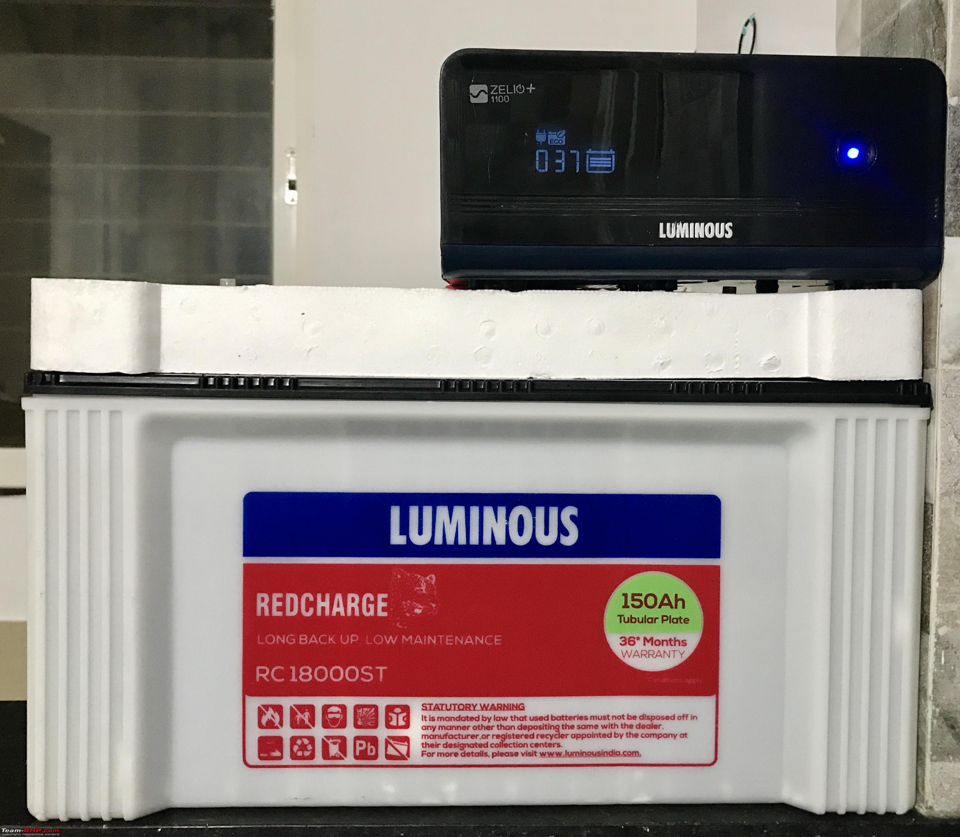

How large inverter are you having ? My typical 150 AH Luminous set is almost 3 yrs now in Pune, and never ever the water level went below the threshold for all the indicators.
I bought a distilled water bottle from a local battery store which I didn't have a requirement to use so far, it showed a TDS level of 3 on my MI water tester.

^^Remove the caps of each cell and check the water level. There is no way a battery's water level won't go down for three years. The indicator/sensor that Luminous sells is not dependable in my opinion. After all they give a sensor for only one cell.
I have the same Luminous inverter and it's tall tubular battery takes in ~ 1.2 itres of water every four months. I did not buy the water level indicator for the above mentioned reason. The original Luminous tall tubular battery lasted eight years and recently I replaced it with Amaron.
Gansan is offline   (1) Thanks

I am not talking about the electronic indicator which luminous sells which i mentioned in this post here:
https://www.team-bhp.com/forum/gadge...ml#post5384560 (Inverter Batteries)
The battery comes with float indicators with green and red markings and if water level is below red we are supposed to top it off. None of the 6 indicators went below red in my case. Are you suggesting that they are faulty and I should open up and have a look ?
I will remove the float caps and check/top up every four months even when they show good level of electrolyte. They may be struck in position sometimes, though all six getting struck is very very remote. But still, a battery not needing top up for three years is highly unlikely. So better remove the caps and ensure.
The new Amaron battery I bought last year has only one float for all six cells, and it shows full. But still I check once every four months.
3 years and no top up? Something is wrong and you need to do a manual check. I have a 1.5 KVA inverter with 2 x 200 AH tall tubular batteries and they require a top up every 2-3 months depending on the weatrher. I had last topped them up in mid Feb and another top ip is due now. We have hit 40 C and it's really hot!
Please check water levels manually and at regular intervals. Your floats are obviously inaccurate.
