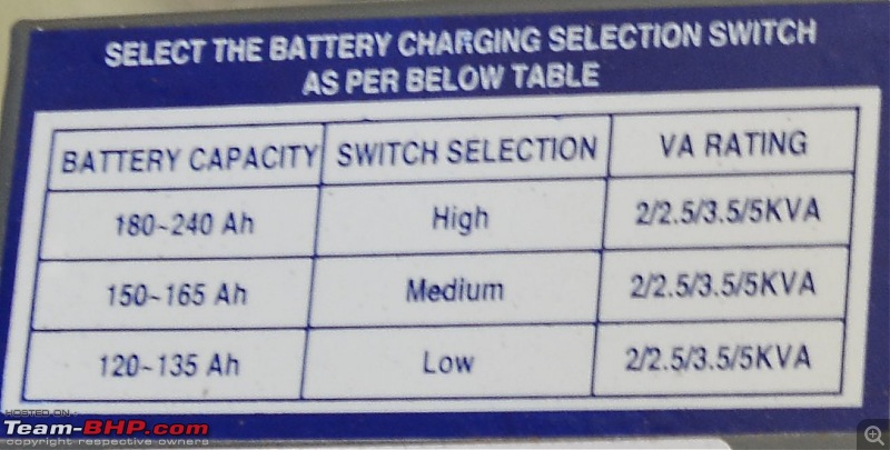

Anyway 2A at 220V should give 220/12 ~ 15A (after taking into account efficiency etc) at DC end good enough for 200AH battery charging
I have two 200AH batteries coupled with my 2 KVA Cruze-Luminous UPS. It has been working perfectly for the past 3.5 years.
The "Rated current" as given(photos attached) is 9.5A at 230V AC. I think this is also the maximum current to charge both the 200AH batteries when they are nearly empty (the charging current reduces as the battery becomes full).
