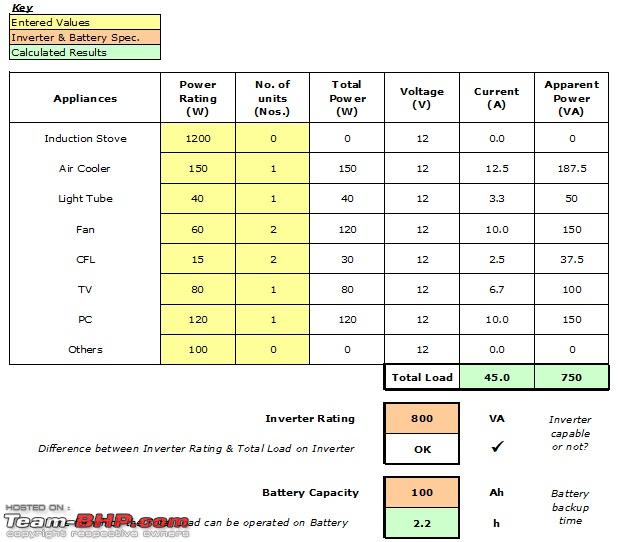

Hi Friends,
I have shared a spreadsheet in which I have made a short calculation for deciding on the Inverter Rating and Battery Capacity, which can be edited to each of our requirements and checked. I think it is self explanatory, shown below is how it looks like.
What needs to be filled by us are the number of units of each appliances (yellow cells) we need to get working on the inverter, along with the available options for Inverter Rating and Battery Capacity (orange cells), to understand, if the inverter is capable of supporting the total load, and if yes, what the battery backup time is, with the total load. The Power Rating mentioned in the sheet are standard/common values and can be edited (yellow cells) if you find a different rating on your specific model.
Please note that some 1.2 (or more) factor of safety needs to be considered for both... meaning, if the total apparent load is 1000W, then inverter should be at least 1200W and if backup time with a 100Ah battery is what you need, then you should go in for at least 120Ah battery. Kindly also note that, we might have some 7-8 appliances connected on the inverter line, but we might be using only 3-4 appliances at a time, so the Inverter Rating and Battery Capacity can also be realistically decided based on it.
With best regards.
