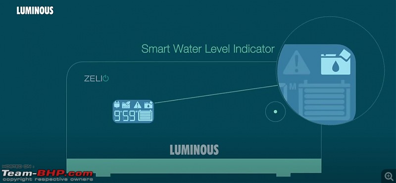

Anyone using Luminous e-float sensor for their Zelio inverters ? I bought this sensor recently, however it didnt seem to work as intended. Wasn't showing the electrolyte level low warning on the inverter when its not submerged in electrolyte. Also this sensor seems hard to come by, I found it getting sold by a Amazon retailer.
I have the inverter but did not buy the water sensor. I was not convinced about how one sensor in one cell could indicate the level of all six cells.
