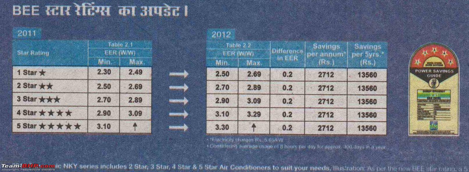

Old and new EER ratings.
There have been doubts about these many times. So I have now scanned and uploaded these from a recent Panasonic advertisement.
The home / office air-conditioner thread-panasonic.jpg
This is a clear guide, thanks.

@Pallavi; See post 2559 above. 5* just says EER 3.3 and above. A good inverter model should run rings round a non-inverter model. LG should be good, but Hitachi is a premium label. Also, take a look at Daikin, General and (maybe) Panasonic. These three are supposed to be the kings of the split world.
Since you are not on the coast condenser construction (aluminium or Copper) should not really matter for you.
