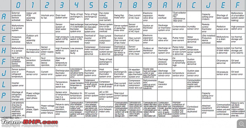

Daikin Inverter Blinking problem
Having problems with my Daikin 17-2.2TR split, R410a Inverter, installed in the 3nd week of December. After working very well for over a month and a half it is tripping every few hours. It goes off with the light blinking. as per the booklet it is a choked filter. Cleaned it even though it looked quite clean. Again it stops about 3-4 times in the night. When it stops the unit has to be switched off with the remote, then powered down and back up. Again gives a couple of hours or so. Complained yesterday and expecting a service call today.
I have been having nearly the same problem starting from the eleventh month (now in the 13th month, so warranty has expired ). I say 'nearly' because once the machine starts, it never stops and does a good job. Only when the mains is switched off and then on (after the 3 to 4 minute time delay of the stabilizer) it sometimes starts blinking the green led and refuses to start.
Unfortunately there are insane power cuts in Tamilnadu, like the power goes on/off at-least 3/4 times every night .
So every night my sleep gets disrupted since it starts blinking and does not start again after the power-cut. Like you said I have to then switch off the circuit-breaker on/off (with its 3 min delay). Sometimes it takes multiple times like this to make it work. Somedays it never restarts, so I give up and go to sleep.
Daikin service guy came thrice but could not find a proper solution.
They then blamed the neutral wire coming from the EB side.
I then bribed the EB guys to come down and clean up all the wires (3-phase supply) from their side.
The problem still persisted.
Then they blamed the earth cable.
I then dug up my earth pipe sunk into the ground, cleaned it, had the pipe and soil around wet with water daily.
Now after researching on the internet I found the way to find the error codes with the remote.
(It is given in some user-manual for other countries downloaded from the net, but not in the Indian printed manual).
It is the 'U4' which means 'Communication error between indoor and outdoor unit'.
Now I asked the service guys to try changing the 4-core wire between the units.
He kept blaming the 'unclean' power-supply from EB.
But miraculously for the past few weeks it is working fine (So the cable may not be the fault).
I have attached file(s) downloaded from the net for finding the error-code (But it may vary between models).
My model is FTKD60FVM, 1.8 Ton Inverter.
Please post your further feedback on this thread, It may help to solve my problem too.

The cooling was near zilch last night. The chaps came this afternoon and found almost no refrigerant in the system, and also a tell tale oil stain. They are expected this evening to fix and recharge. Let us see.
Also, can you give me the URL for these codes.
But how could a brand-new machine lost its refrigerant, that too from a reputed brand?
Maybe the installation was not done properly?
Maybe the installers were not trained to handle the high pressures of R410a gas?
Did you confirm that that is indeed the fault, the service guys may be wrong.
(Try finding the error-code yourself to confirm loss of refrigerant).
When I had my problem I was desperate and googled through a lot of web sites.
I had downloaded a large number of Daikin technical-manuals and went through them.
The error-codes appear to be the same for all the Daikin machines.
here is one: http://www.refrigeration-engineer.co...in-fault-codes
And here was the way I found out my error-code:
(text below taken from the net):
"Press the Temperature UP, Temperature DOWN and the MODE buttons all at the same time. I repeat all 3 buttons at the same time.
You will see 00 on the remote controller. The first "0" will be blinking.
Stand facing the particular air conditioner you wanted to test.
Now press the Temperature UP button, "0" will become "A" and the air conditioner will respond with either a single beep or double beep.
Carry on pressing the Temperature UP button and listen to the beeping sound, stop when you hear a double beep. For example: it is now showing "C0".
Now press the MODE button, the second "0" will be blinking.
Now press the Temperature UP button, "0" will become "1" and the air conditioner will respond with either a double beep or a continuous beep.
The continuous beep is the error code. For example "C4", it means it is a faulty liquid pipe thermistor"
Mine gave 'U4'.

Also, I have the same button for Temp up and down. So will have to figure it out.
Mine too!
You just have to press the whole width of the temperature-button (use the thumb) along with the mode-button for a few seconds.
Try it!
(try it when the light is blinking and not when it is working)
I could not find much. The link from there is broken.
Well, M5_fan has given the link.
Please search in http://www.refrigeration-engineer.com/forums for many ideas.
(have sent you my email-id through team-bhp)
Originally Posted by alpha1 View Post
To be honest - most power supplies in India are indeed exceptionally unclean with respect to neutral and earth, and done by thoroughly incompetent fools (electricians, building contractors).
This also includes the utility company personnel.
True, In one of Daikin technical manuals I read that 'irregular waveform' of the power supply can also give the 'U4' error (which I get intermittently and not reproducible at my will. Maybe an electrical-engineer with advanced instruments can detect this).
Anyway mine is now working perfectly even after 3/4 times power-cuts every night.
The problem magically disappeared!
