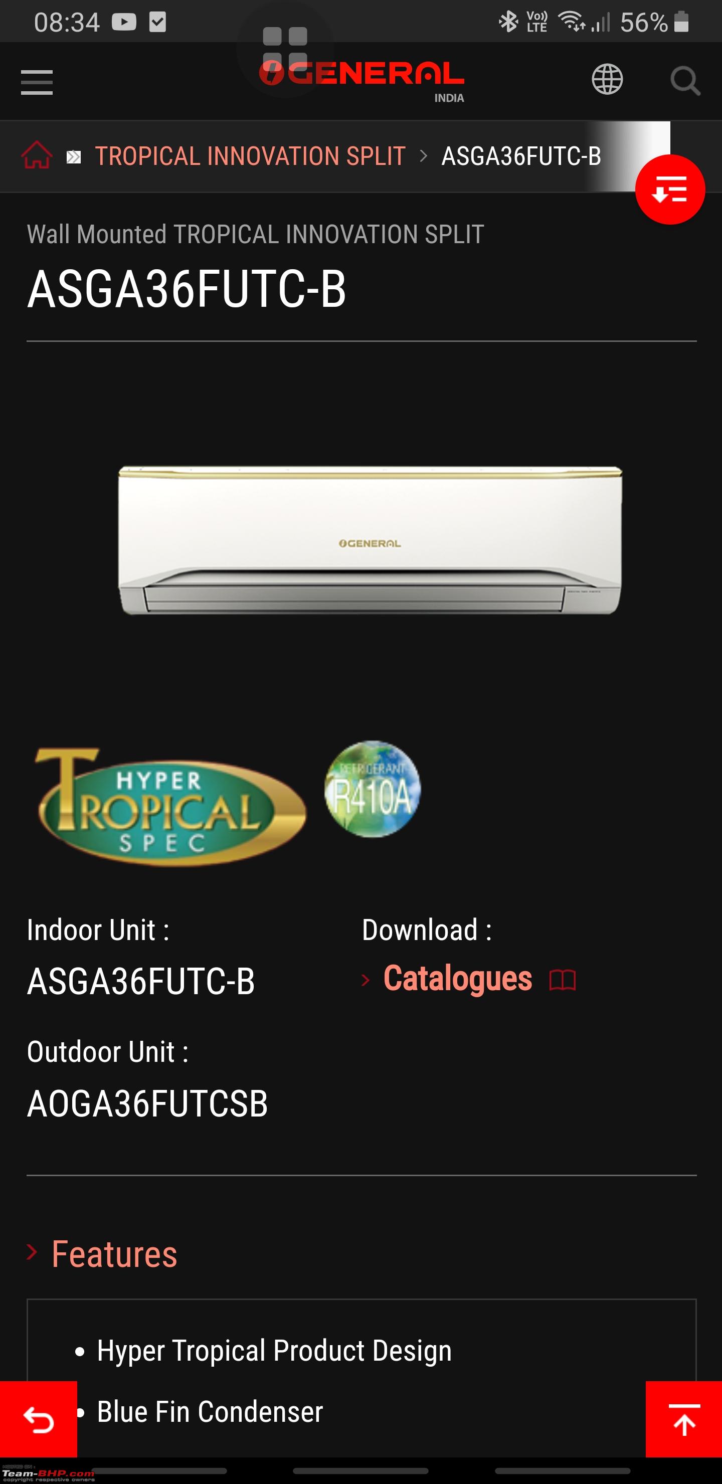

Old 3rd December 2022, 08:35   #7229
Rshrey22's Avatar
Join Date: May 2017
Posts: 372
Thanked: 729 Times
Re: The home / office air-conditioner thread
Originally Posted by sunilch View Post
Apologies if this has been answered earlier but I was not able to find any post that may answer my query.
Office space in Mumbai needs a/c fitting now. About 350-370 sq ft in space (for seating). An approx 80 Sq ft. boss cabin / meeting room for 4-6 people to meet at a time and the rest is staff seating area.
The outlet pipe and space for ODU is limited and hence I was wondering if we can fit 2 IDUs with 1 ODU. I searched internet and came across this VRF system by different vendors such as Blue Star, Mitsubishi Electric and Carrier. Looks good from requirements perspective but I am not sure about the cost benefit of the same.
I was initially thinking of putting two Split units of 1.5Tn each - 1 in the meeting room and the other in the outer seating area, before this idea of a combined ODU came to my mind.
Not seen it in action anywhere and hence seeking feedback here. What should be the recommended size and configuration in this case?
While two ODUs can be managed easily in the given space, two pipes going out of the office via the same place (and cover about 100 meters) might just be a bit of pain.
Alternatively, if I put 1 Cassette unit, what will be the recommended size for it? 2Tn?
Single General Split Ac 3.5 ton will do the job for your requirements. Here's the model number
The home / office air-conditioner thread-screenshot_20221203083448_opera.jpg
Rshrey22 is offline
