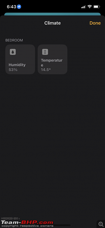

Originally Posted by Gansan View Post
When the ambient temperature is in the high thirties or forties, if you set the temperature at 20, your display will show 20 but your room will never reach 20, and the compressor will run the whole day without cutting off.
The norm is to set it 23-27 degrees to feel comfortable. Believe me, when the ambient temperature is 33 degrees, even 28 will feel comfortable.
There is no way to control the temperature of the chilled air coming out of the Ac. It will be a constant 18 c. What we are doing is setting the thermostat at a desired temperature, so the compressor cuts off when room air matches it. If we set it 12 degrees below ambient temperature, that is never going to be reached, however long the Ac runs.
Was interesting to read this discussion. It is a personal preference and this is what I get in Delhi heat in my room with an almost 15 year old Samsung Split AC. Two different temperature sensors it is for this reason I dislike how the climate control goes only to 18 in my car before low, unlike the GTI which goes to 16.
An over sized AC will get you as cold as you want.
