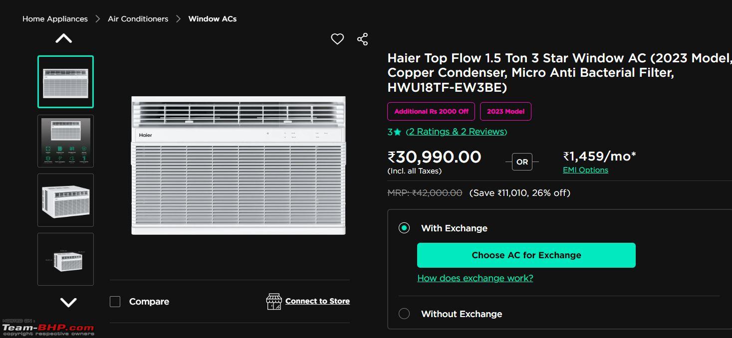

After looking at all options, I have finalized two window AC's. Both fixed speed and looking for the most durable/reliable and resistant to corrosion.
First is a great deal from Haier. 1.5 ton and has a 5 year comprehensive warranty standard. Warranty is the only reason why I am even looking at Haier. Also is quite cheap at under 31k.
The home / office air-conditioner thread-ac2.jpg
Second is a General window AC, with a single year warranty and a 12k+ price premium. Cons are the price premium and single year warranty.
Thinking of going for the Haier for the 5y warranty, any suggestions guys?
Doge is offline
You seem to have read the General warranty for their inverter ACs, i.e. 1 year on the whole unit and 10 years on the compressor. On the fixed speed models General gives the same warranty as others, i.e. 1 year comprehensive and 5 years on the compressor.
anupmathur is offline
