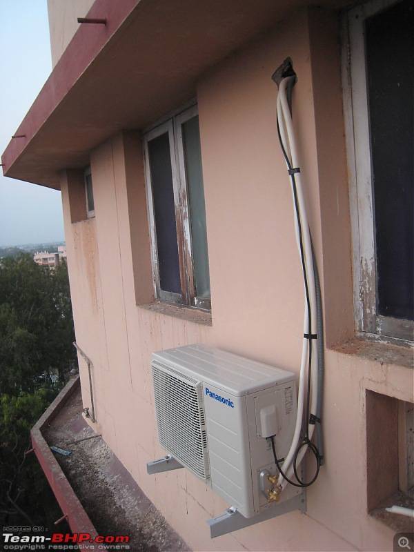

Posting a few pics of the Panasonic Cube 1.2t AC which was installed at my place last week.
My initial impression of the unit is as I mentioned earlier. It's got a powerful blower which cools my ~150 sq ft room in minutes. The fan blows air over the oversized cooling fins, hence the cooling occurs much faster. Relatively silent. Waiting for the bill shock at the end of the month. It could have done with a little more choice in fan speed than just low and high (nothing in between). Both the inner and outer units are "Made in Malaysia".
But IMO it would look ugly in a living room, but again, its just my opinion. Looks a little "fat" Very good VFM for a bedroom AC.

Thanks for the snaps Neilguy. I like it a square indoor unit instead of a rectangular one, very interesting. I especially like how the air filter can be pulled straight out from the bottom, sure beats climbing up on a ladder etc to get the filters out from regular ones. I will await to see your post regarding the units consumed over a week, fortnight or a month of running, whichever period works for you.

Looks interesting. Agree with the good filter design. Slide out is adapted from the Window Technology. Yes, does look a bit bulky.
