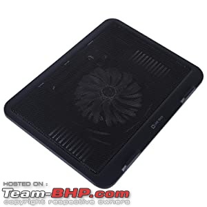

With Wifi routers working extended hours due to WFH, some of us may be facing hang issues frequently. Most of the router models have very poor thermal design and this leads to issues like auto restart, hang etc particularly if you have kept the router in a poorly ventilated area. This also can affect the life of the router.
I have been facing the issue of system hang once in two days or so. The router surfaces were too hot even to touch. So got one of the laptop cooling pads from amazon.
https://www.amazon.in/gp/product/B08...?ie=UTF8&psc=1
The results has been excellent with the router surfaces getting cooled down significantly.
You don't need a fan with high CFM, even a low rpm USB fan which can recirculate the air will help. You can also have a DIY set up using cheap CPU fans. Since this pad itself was so cheap, I did not bother to try that out.
Also make it a point to shutdown the router in the night.

Our router gets 24-hour use! It only gets turned off when we go out for more than an hour or so.
As I have mentioned, our new router shows up the old one to have been rubbish, which I thought (and hoped, spending the money to replace it!) would be the case. The old one used to run at warm-plus. One of the nice things about the new one is that the case is pretty cool to touch. I can just feel warm air coming out of the top ventilation. Must be well designed.
It is good advice to keep all electronics, from wifi to hifi, as cool as possible. Do not keep in enclosed spaces; do allow air flow all around. And, with the hifi stack, increase the space between components. Hint: the manufacturers don't want you to do that. They don't want you getting years more use out of your kit!
I think you got a pretty high end model, so obviously it will have an internal fan. Most models south of 5K will be having only passive cooling with vents.
I think wifi routers are the most overworked electronic devices now a days. Most other devices will have some sort of power management or sleep states or won't run 24x7. Also many keep the routers in inherently hot places like kitchen for better coverage. This will adversely affect your device for sure.
The simplest thing one can do is keep the device min 1 inch lifted from the surface, Most routers will have power dissipated from bottom. So a better air flow at the bottom cool down the device significantly.

Upright designs have better thermal management. Still if the ambient temp is high and the router is kept in a non ventilated area you can run in to issues in long run. One guy has done elaborate testing with your model it seems.
https://www.skooterblog.com/en/2019/...8u-aliexpress/
If you use one band mostly, try shutting down the other one. This can also help save some power.

Router hang normally occurs due to outdated firmware and sometimes also depends on type of traffic flowing through it. Though thermal factor does impacts the productivity, but rarely induce a hang.
Try updating your router firmware to latest available version and verify the system configuration.
Switching it off is not solution, since these devices are made to operate without fail or interruption.

On the topic of thermal issues on routers due to the 24/7 running of WiFi, it's mostly related to firmware quality and might not be thermal. I have a DD-WRT router (8-year-old TP-LINK WDR 3600) which is running 24/7 and everything is groovy. I have seen uptime of more than 60 days on it without any hang or reboot. Off late, I have introduced a weekly restart to clear out the RAM, etc. Regarding the load, it has around 20-25 devices connected to it through WiFI on three different SSID's (the main SSID, guest SSID, and one dedicated SSID for IoT devices). Also, it has all of its LAN ports connected to a family PC, a WD Mycloud, a PS4, and a Chromecast. With 3 or 4 devices streaming HD content simultaneously from Netflix or the likes and me and my wife working from home, it hasn't missed a beat till now. Also, there is a QoS set up on it which is working pretty decently on the 50 Mbps WAN connection. So yes, these things even with passive cooling are designed to run for extended hours
