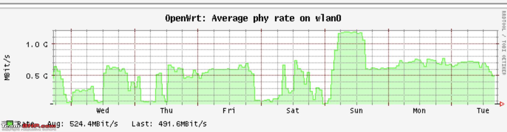

This is the performance (attached screenshot)I get with my 802.11ac when mostly browsing from other rooms. My WiFi router and Internet point is at the extreme corner of the short leg of a long “L” shape typically 18 ft away and I never saw anything close with 802.11n.

This is the performance (attached screenshot)I get with my 802.11ac.....
Do you use 1 gbps connection ?
