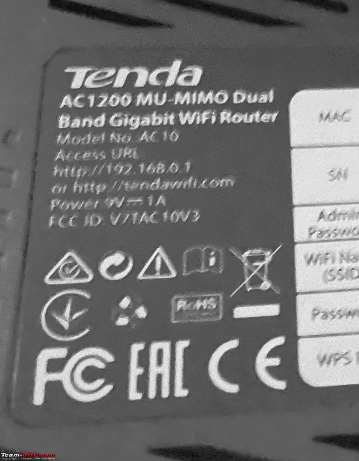

Dual Band indeed. As per ACT technician, you cant buy this outside since the fiber optic wire goes in directly. I wanted to install a gaming router costing 25K. But this had that additional aperture. Speed is fine with me
Originally Posted by dadu View Post
This is Tenda AC10 will max out at 867Mbps on AC. Although its provided by ACT. If one has to buy himself, I would suggest buying at least AC2100 Dual Band router. This will take care of Giga speeds on Wifi 5 (AC), Wifi 6 routers are currently expensive to procure.
