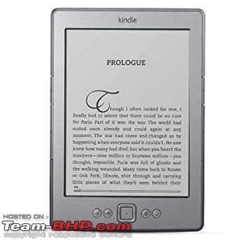

Hi guys. Facing a weird issue with my kindle. (Its one of the older 2010 models with the page turn buttons).
The page turn buttons on both sides have become very tricky to use. Each and every time I try and press any of the page up or down buttons, I have to press the back cover inwards since the cover protudes out and doesnt allow the button to engage.
What is the issue? I am facing this since the device was a month old but haven't used it much for the past 9 years. I did remove the cover and reinstall it but to no avail. I want to use the Kindle since it is working well otherwise.
The model number is D01100 for reference and this is how it looks.
Does it make sense to spend 6K on a new Kindle BTW? What kind of offers can I expect? I have a prime subscription.

I have a hunch that the battery in your Kindle may have swollen. The fact that the back cover is protruding out points to a swollen battery which in turn distorts the overall shape of the kindle. The buttons are therefore not making contact with the PCB inside. Check your battery and if swollen you could get it replaced.
