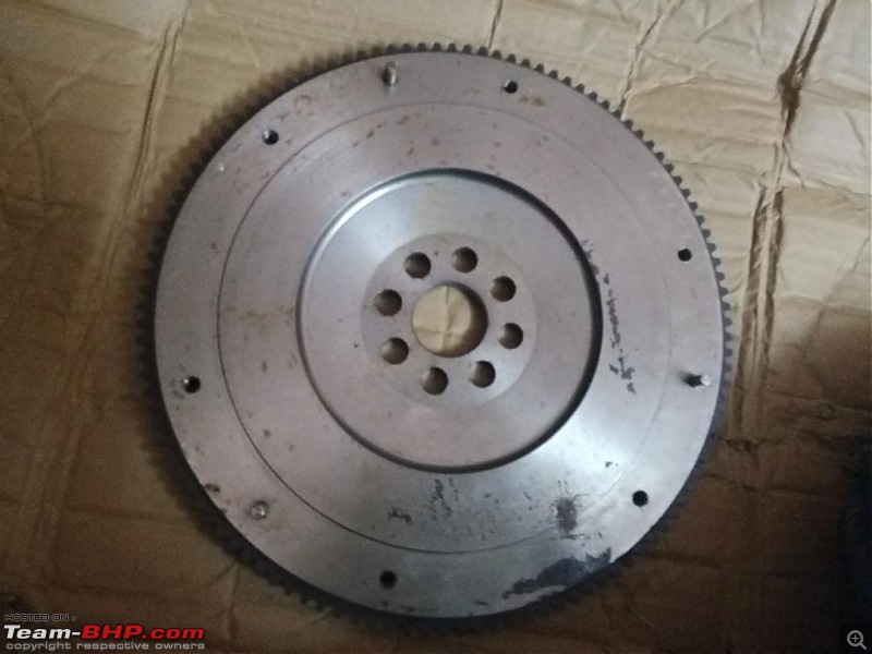

My Civics clutch was juddering intensely in rear and first at slow parking speeds. I could also feel I can’t describe in rights words but say at 5th gear at 1.5 to 1.9k rpm I will feel the car will struggle to accelerate a bit on a smooth straight road. I believe this is a symptom of the clutch slipping and that the flywheel was on its way out as well since it was juddering at lower gears so I decided to do away with both.
Bought the clutch and flywheel from a local parts shop after Honda informed me that they will be draining my bank account of around 30k if I wanted their genuine parts and service. (15k for the flywheel and rest for clutch plate and labor). Got a quote of around 6.8k from my parts shop just for the flywheel and 4.3k for the Daikan clutch plate and 900 for the release bearing. I placed the order in the morning and the shop delivered around 3 PM the new flywheel and plate. These things are heavy and in case anyone wants to go shopping for these make sure to get a vehicle with you for transport. Definitely not something you can just go to a shop with a carry bag and buy.
Gave the car to Devabhai on sat and got it back yesterday. He charged 3.5k for the overhaul. Decent work done by his guys. The Clutch feels extremely light, the shuddering has disappeared though I can feel a mild tremble. I have only driven the car for 20 kms after the change and will report any further observations. I got the work done at half price at what it would have cost at Honda. Pai motor extorted 13.2 for just the overhaul. I remember going back to the owner few days after the overhaul was done back then with the shuddering problem. He turned his back on me after saying it will go away after 500km of driving which it didn’t and today I ended up replacing the stuff he had put in all over again.
I wonder how long I can continue with this car. I have replaced/fixed many stuff twice in the last 6 years and 60k + kms that I have done on this car. Considering it’s a used one I hope this is normal.

The new flywheel. OE Honda (as per parts shop owner)
Honda Civic Independence : CNG'd. EDIT: 1,13,000 km up and SOLD!-flyswheel1.jpg
Honda Civic Independence : CNG'd. EDIT: 1,13,000 km up and SOLD!-flywheel2.jpg
The old clutch and flywheel. As per my garage guy CNG puts extra stress on the clutch components etc as it runs more hotter than normal petrol and leads to more wear and tear. One more reason not to run the car on CNG.
Honda Civic Independence : CNG'd. EDIT: 1,13,000 km up and SOLD!-oldparts.jpg
Honda Civic Independence : CNG'd. EDIT: 1,13,000 km up and SOLD!-old1.jpg
The flywheel had marks on its side.
Honda Civic Independence : CNG'd. EDIT: 1,13,000 km up and SOLD!-oldflywheel3.jpg
Honda Civic Independence : CNG'd. EDIT: 1,13,000 km up and SOLD!-oldflywheel.jpg
