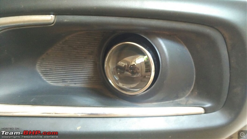

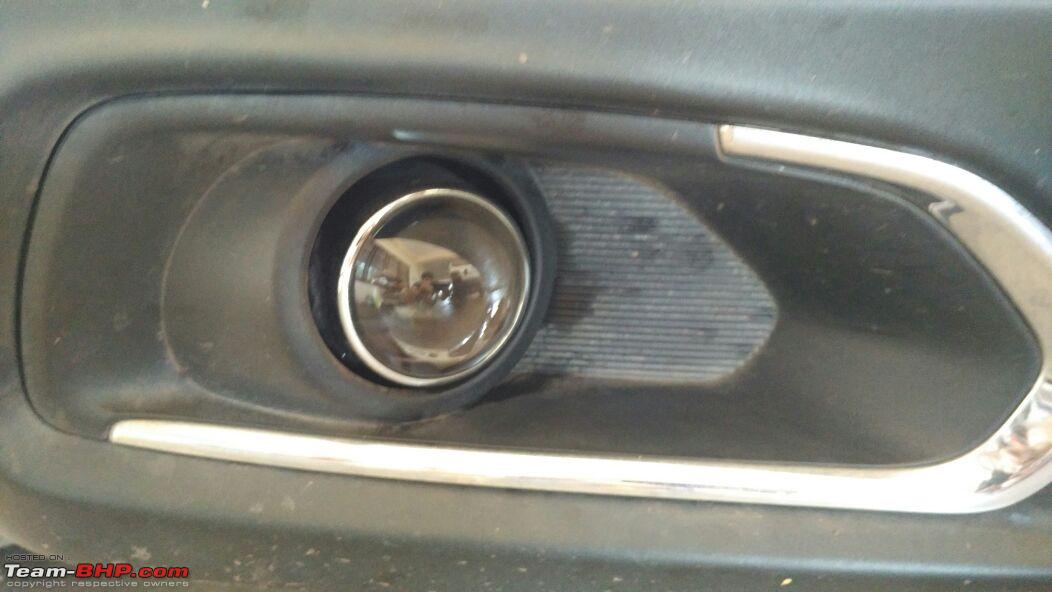

XP Micro Feedback after driving 2500 KM
I am very happy with the output. I had little doubts regarding sturdiness of lens, water and dust proof claims. Xp micros have taken the abuse well on all kinds of driving conditions. There is not even a single scratch. Also its really water and dust proof. Posting pics of the same.

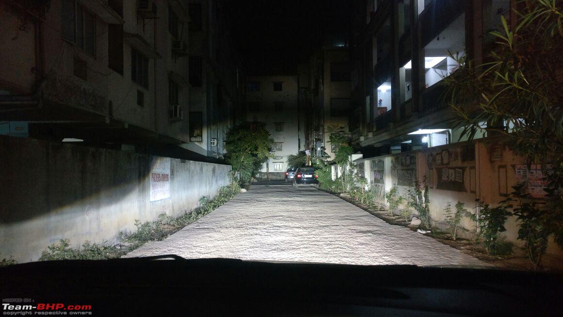

Thanks to Mr. Warun from Hyderabad for sending the output shots of XP Micro on his S-Cross!!
Low Beam :
Stock headlight
XP Micro: Bi-Xenon Projector Foglamps. EDIT: Terrible experiences-img20170120wa0011.jpg
XP Micro
XP Micro: Bi-Xenon Projector Foglamps. EDIT: Terrible experiences-img20170120wa0008.jpg
Stock HL + XP Micro
XP Micro: Bi-Xenon Projector Foglamps. EDIT: Terrible experiences-img20170120wa0013.jpg
High Beam :
Stock headlight
XP Micro: Bi-Xenon Projector Foglamps. EDIT: Terrible experiences-img20170120wa0012.jpg
XP Micro: Look at the massive difference in output these small micros do
XP Micro: Bi-Xenon Projector Foglamps. EDIT: Terrible experiences-img20170120wa0009.jpg
Stock HL + XP Micro
XP Micro: Bi-Xenon Projector Foglamps. EDIT: Terrible experiences-img20170120wa0014.jpg
This is the 5 th S-Cross Alpha to get XP Micro installed and surprisingly all were 1.6. Yes, 1.6 S-Cross badly deserves better light. What's power without control?

Do you realize that you are blinding people who at the height of 25-30 ft from the ground? The high beam is reaching 2nd floor of the building in front, which by the way, is quite far away. While I agree these lights have power, I disagree that these are in control.

The lows are perfectly aligned, it's only the high beam that's pointing a little above, but a sensible driver will know when to use and avoid the highs.
I disagree. Its well within control and fully practical. And nobody is going to run only on high beam . Yes, you could have said these lights are not in control and blind everyone for only those idiots who would drive without sense.

Even the low beam is slightly aligned upwards, and you can notice the Low beam cutoff of the XP going above the car ahead. That should not be the case actually. See the OE projectors which cutoff right at the bottom of the car to the right and slightly higher up to the left, which is how low beams should actually be focussed.
IMO, its a better idea to bring the axis of the XP a little downwards, since there is no point in illuminating 20ft above the ground and wasting the light output to illuminate the sky. Rather pointing it down will put more of the light onto the road and obstacles ahead and still give a good throw onto the road.
Agreed. I have aligned the XP Micro low beam "lower" than my stock HL low beam. I did this to avoid any kind of glare when in low beam.
