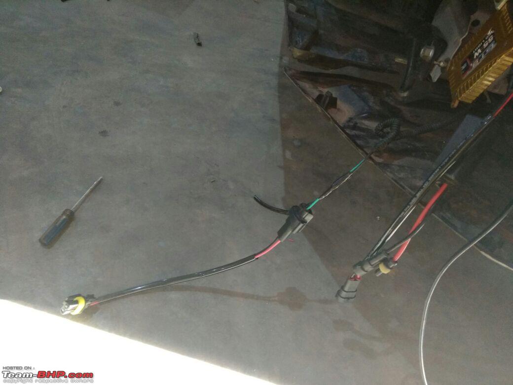

Update : XP Micro shoddy wiring fixed at Blackworks
What was done?
1. All connections are made from connector to connector
2. Speaker wires in Engine bay are replaced by better guage wires.
3. Ballast is securely mounted with the help of custom brackets
4. High beam connection of XP Micro is made safe and weather proof.
5. All wires are well insulated.
6. Speaker wires, splice connectors etc used by XP authorised installer EVO are no more present in my car

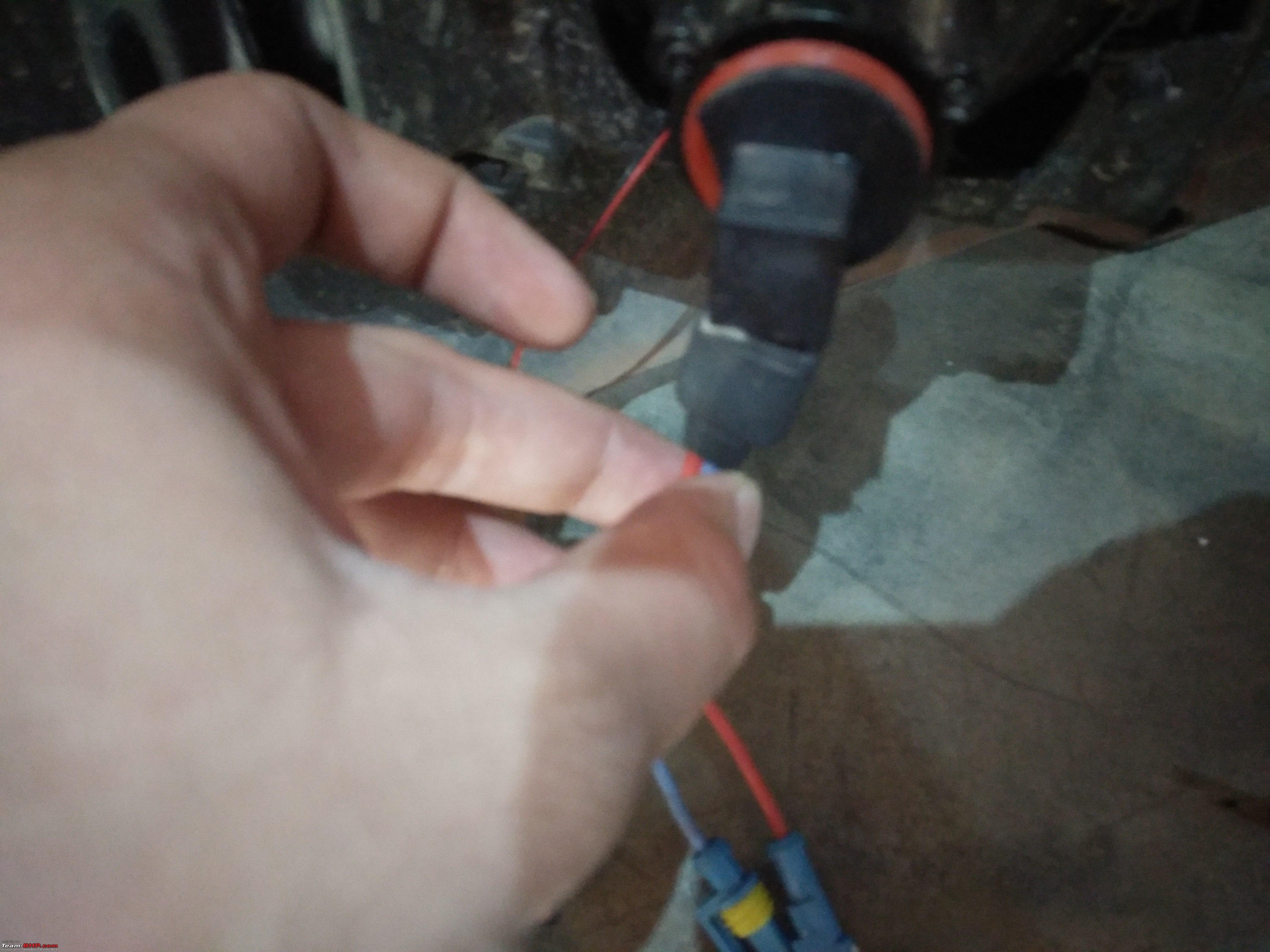

Some bad news :
XP Micro: Bi-Xenon Projector Foglamps. EDIT: Terrible experiences-img_20170709_172921.jpg
We noticed that bulb holder of left side XP Micro was broken. Venkat advised me to replace the bulb ASAP as it would be not safe.
EVO setup : splice connectors, speaker wires, OE fog connector unplugged and exposed
XP Micro: Bi-Xenon Projector Foglamps. EDIT: Terrible experiences-img_20170709_163641.jpg
After fix by Blackworks
XP Micro: Bi-Xenon Projector Foglamps. EDIT: Terrible experiences-img20170709wa0043.jpg
Custom bracket to mount Ballast
XP Micro: Bi-Xenon Projector Foglamps. EDIT: Terrible experiences-img_20170709_173306.jpg
All is well!!
XP Micro: Bi-Xenon Projector Foglamps. EDIT: Terrible experiences-img_20170709_175406.jpg
Thanks to Mr. Shyam for providing H8 to H11 connectors and Sudeepg for providing water proof connector for XP Micro high beam solenoid.
Note : Blackworks is not official installer for Xenon Planet. Venkat just helped the affected S-Cross owners. Neat job as always. I am impressed. Thank you!!

Update on the XenonPlanet Micro related issues
As you may know, some of the early adopters of XP micro had poor install done by Evo as detailed on this thread.
Short Summary - Good news! - Issues in affected cars are being sorted out and install is pretty robust now.
Details
July 3rd was the deadline set by XenonPlanet for delivering us with a kit which will fix the shortcomings from a previous install by Evo. XP did ship a couple of kits to the affected folks by this time but didn't have the workshop to fix the problem since the affected folks declined to goto Evo. Today, Shyam reached out to us to fix the issues. The fix summary:
  1. Input power cables from stock connector provided. They are a secure fit now
  2. Ballast securely fixed with custom made brackets and bolted to the body.
  3. High beam solenoid connected with the water proof connector. This makes it easy to remove as well as plug and play
  4. Solenoid tapping with new set of PVC insulated wires, and the tap sealed with heat shrink tubes.
  5. Separate tapping for left and right projectors.
  6. They removed bumper and did a clean job.
About BlackWorks: The garage is a good place with ample space, tools and hardware to carry out major hardware level upgrades on the car. Venkat and Shyam were hands on with the work today along with their installer, whom I would say - talks less and does his work. He definitely knows his work well and it was demonstrated in the way he went about doing it. More importantly, it was their attitude of doing things right that struck a chord with us. They are proficient in tools and knowledge of car wiring. Our suggestions were not met with excuses or counter arguments, rather where feasible they did the correct work. Venkat personally did some of the connector crimping and wire related work.
A big heartfelt thank you to Shyam, Venkat and his installer. We are pretty sure the wiring is robust now.
Thanks Sudeep for the detailed fix summary. Nothing to add further! Big thanks for the time and sparing the water proof connectors etc for my S Cross. I can summarize the install is safe secure and detachable now!
Big thanks for Shyam, Venkat, his mechanic. The snaps shows the quality of work .
