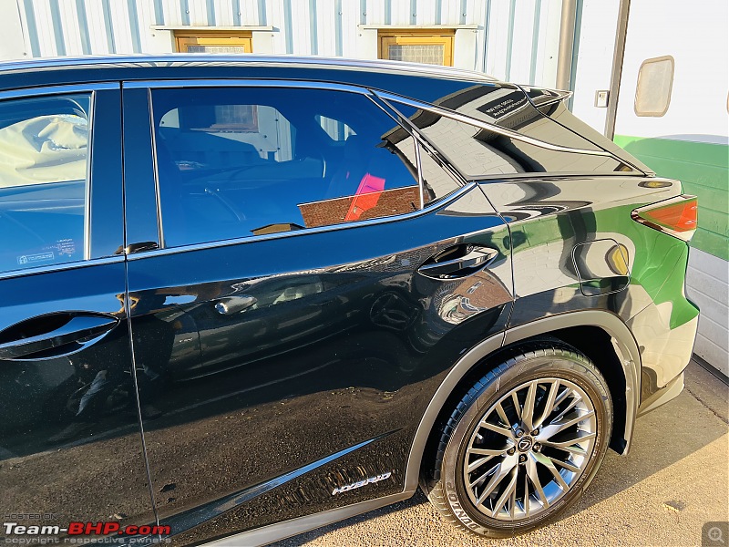

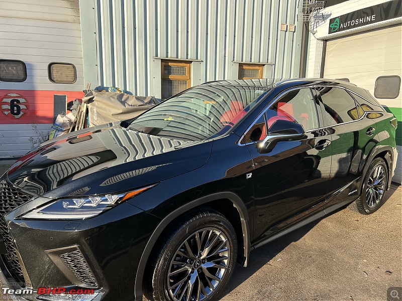

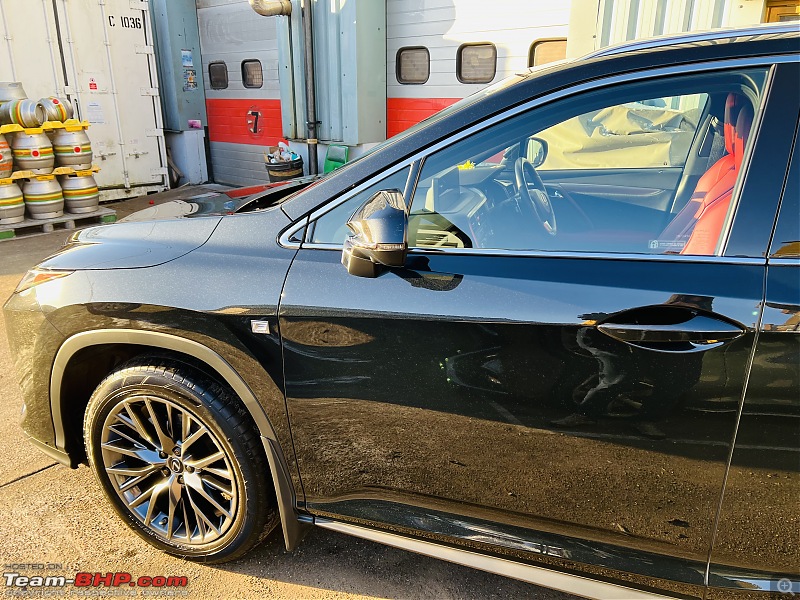

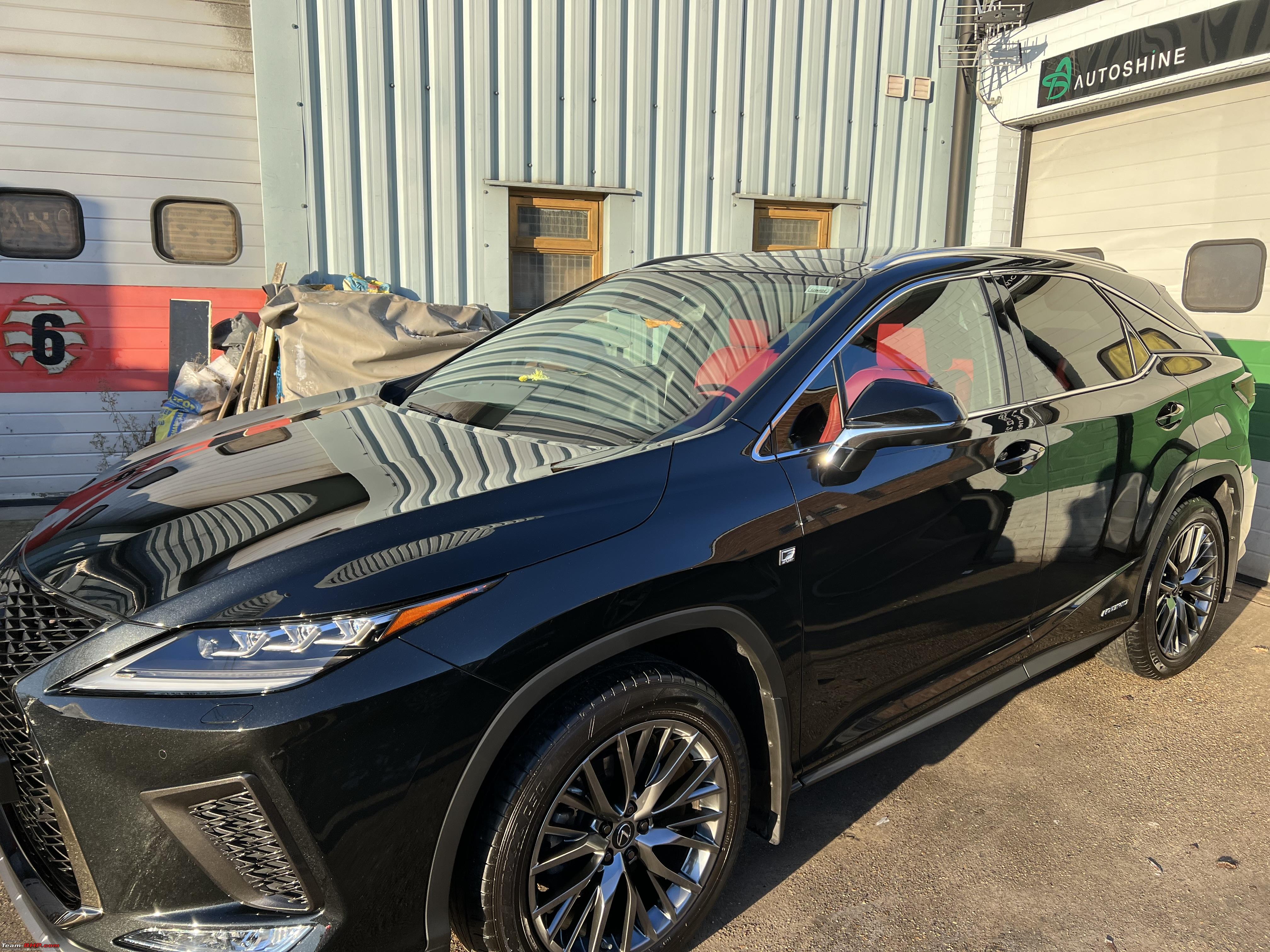

Originally Posted by AravBS View Post
Friends, I am in the market for getting my new car ceramic coated. My Car, Kanakapura road coated 30k for the sedan and they use Gtechniq . Any reviews for this brand ?
Here in the UK, it is a pretty common brand. I did this last week, the detailing specialist used Gtechniq Crystal Serum Light for my 2021 registered car. I was very satisfied with the outcome:
