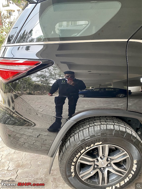

Google is everyones friend! Please research on coatings, pros and cons as well as good detailers in your area. Getting a good ceramic coat is absolutely worth it for a car guy. Many people in this line of work are misleading people, but social media if used properly educates everyone. Leaving you with a pic of my 7 month old coated car mirror mirror on the wall, who is the prettiest of them all , heck i would get a coating if i bought an alto or a ferrari!
As an auto enthusiast my car is my love
Also no offence to all the gentlemen recomending car repaint, dear sirs please get it done and see the reasale of your car sink like tittanic if your ever plan to sell it in the future!

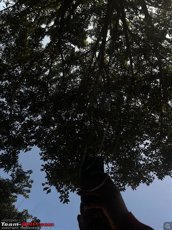

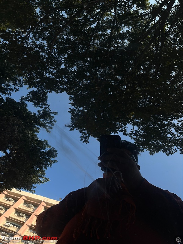

Hello everybody!
My ceramic coated Creta has completed approx. 26-27 months and accumulated a decent amount of micro-scratches and spider-webbing. It recently acquired some noticeably scratch marks on the bonnet, which I suspect to be either monkeys or mischief. Thinking about getting some polishing/paint correction to get rid of these unsightly bits.
The car is still pretty glossy. I have washed it myself (waterless method/Pressure wash) or gotten it detailed. It does get parked out in the open though, so dust is inevitable in the NCR. I also try to cover it when viable (have a heavy duty micro-fiber lined fitted cover), and sometimes use a wax duster to get rid of light dust.
I am looking for a detailer or even a painter who can do a good polishing job, and hopefully, preserve some of the original modest coating. I live in South Delhi and work in Central Delhi - so would prefer these locations. Ideally someplace I can drop and collect the car on the same day.
Not looking for another coating at the moment, as I am quite happy with the sprays from Turtle Wax/Meguair's. If you think this can be a DIY project (without buying a polisher), I am all ears.

Hi, i would suggest you go to the guy who coated the car, he would know what product was used for ceramic, any attempt to buff the existing coating without knowing what was applied will result in you losing the coat.

Update on Autotech Delhi, from whom I got the Modesto BC08 coating and also recommended. I reached out to the owner, who hash relocated to Canada and Autotech is now run by his staff. The owner informed me that as my vehicle was out of the 24 month warranty period, they would charge me Rs. 8000 for paint correction. I would not recommend Autotech anymore as the owner was the real driving force behind it, and I think other detailers offer a longer warranty for their coatings at a similar or lower price point.
First and foremost, a ceramic coat can never be paint corrected! Once a ceramic coat cures on paint, it seals the layer beneath. Hence if you put a DA polisher or rotary to the surface you are bound to lose the ceramic coat! Also depending on pad used, speed of rotary and passes made on each panel one is bound to lose clear coat as well depending on the competence of the detailer.
Secondly warranty on ceramic coatings is like the nigerian mr okawango samuels offering you the 1 million euro lottery on email! Any detailer offering a warranty or gurantee is conning you in the first place itself! Its wise to be a informed consumer and do the research before going ahead with the service
Ceramic coatings never offer protection against swirls and scratches due to traffic. It only protects the paint clear coat and offers gloss and shine, and protects the paint depending on the product used and the competence and work of the detailer. Also key factor and the most important thing is how the car is maintained.
