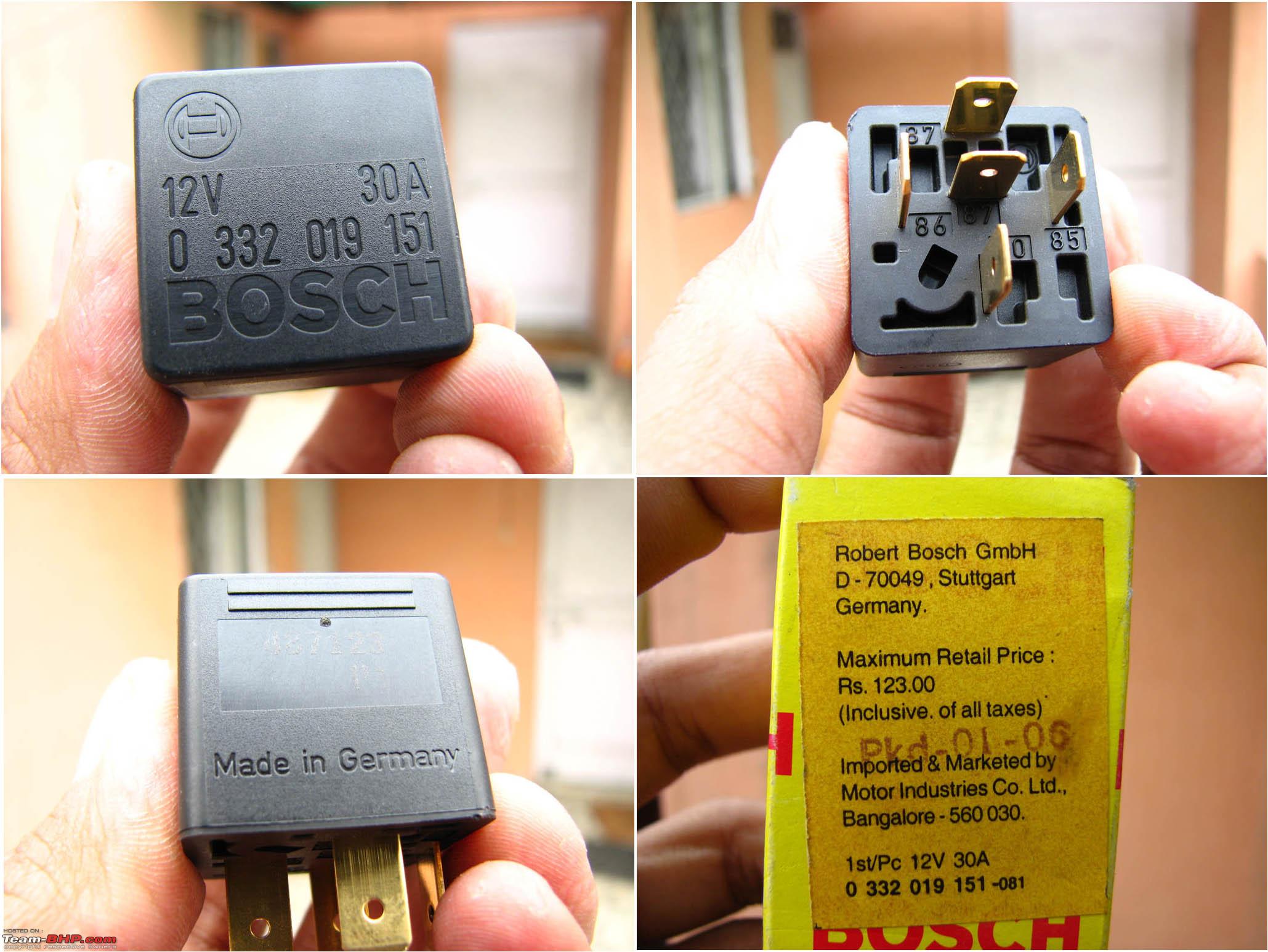

I think I found some original Bosch relays

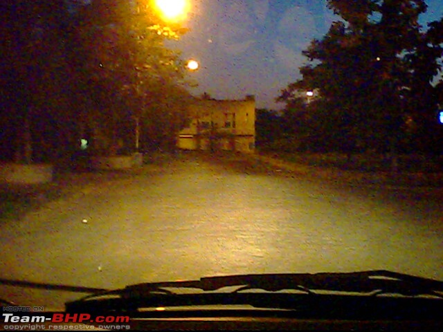

My humble contribution
These are the photos of my Estilo with a pair of Philips Rally 130/100 W,with ceramic holders,twin relay and appropriate wiring.
Time was about 5.30 in the evening with beams pointing towards a small house at a distance of about 100+ yrds.
Sorry for the lack of clarity as pictures were taken on a N95.
