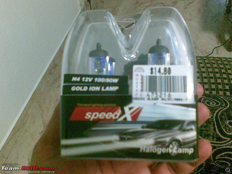

Noticed a 'Gold ion Lamp' on the rack with 100/90 rating (H4). So brought it.
No idea how much different it is from the Philips 100/90 that I have now in my Alto now. Will have to wait to try it on next week when I plan to get back to India for few days.
Also noticed a xeon bulb rated 100/90, but with my previous experience with those, did not get them, even though I was tempted.
Here is a photo of the box (best shot I got!):
Auto Lighting thread : Post all queries about automobile lighting here-image007.jpg
