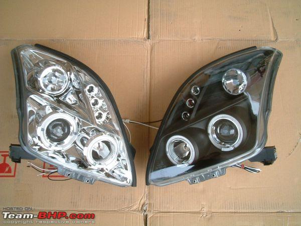

Angel Eyes for Bright Red Swift
Hi Everyone,
I have planned to fit Angel Eyes for my Bright Red Swift VDI. I contacted MotorPlaza in Trivandrum and they have Angel Eyes. The cost is 9500 which does not include headlights. Only contains LEDs I suppose. Installation charge is Rs 130
Is there anyone from Trivandrum , who has installed Angel Eyes in Swift? If so can you please suggest the shop, price as well as the picture of the installation.

3. Which type of Angel Eyes suit a Bright Red Swift. A Chrome one or a Black one. I am attaching a picture of the two taken from EBay.
Auto Lighting thread : Post all queries about automobile lighting here-swiftpro.jpg

Hi Raj,
I reckon you are referring to the projector headlamps. The picture that you have posted is of a custom projector headlamp kit. The angel eyes are the white rings surrounding the 2 projectors which will glow white usually when you switch on the parking lights.
Coming to your question, the black matt finish one is definitely the best looking one.
