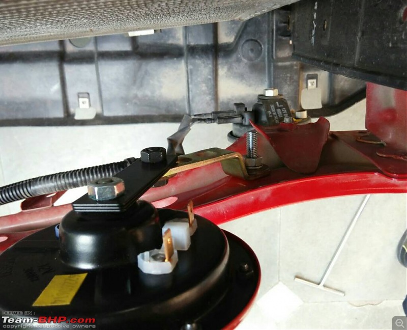

Hella Supertone in My Swift - Mounted a pair on the front beam in such a way that they are visible through the radiator grill but as I anticipated they would barely show because of the angle and thickness of the slats.
Sound is good enough, louder than stock. About as loud as the Hella Spice Tone. The changes can be reversed without much issue as no cutting and taping of the stock electricals was done. The stock low tone horn of still connected so the stock wiring powers that and the relay coil only. The wire from the battery to the relay is a fuse wire cum box that seems to have 3-4 sq mm cross section. Relay to nearby horn is 6 sq mm and from near to far is 4 sq mm. Wires from stock wiring to relay are 1.5 sq mm.
Mounting strips are thick ones that are used to mount plastic boxes on Splendour and other such bikes. Used without modification. DIY installation time was 4 hours because I had to go to multiple places to get the strips, male spade connectors and nuts, bolts and washers.
